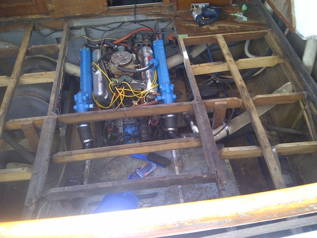

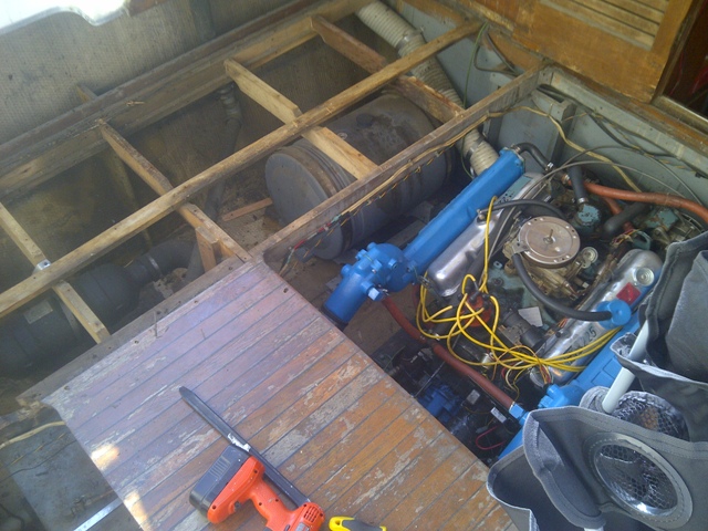

So took floor off to replace rotted frame wood and floor it self is ok but old and lot of holes to fill after screws being taken out. Floor was basic 1/4 inch plywood with what looks like 1/4 teak sheeting I guess glued to it. Decided to replace florring with marine plywood but not sure what to cover it with . Not sure want to go with wood , maybe vynel or something similar . Any ideas with pictures what others have done would be greatly appreciated

- 2.jpg (146.58 KiB) Viewed 5314 times
