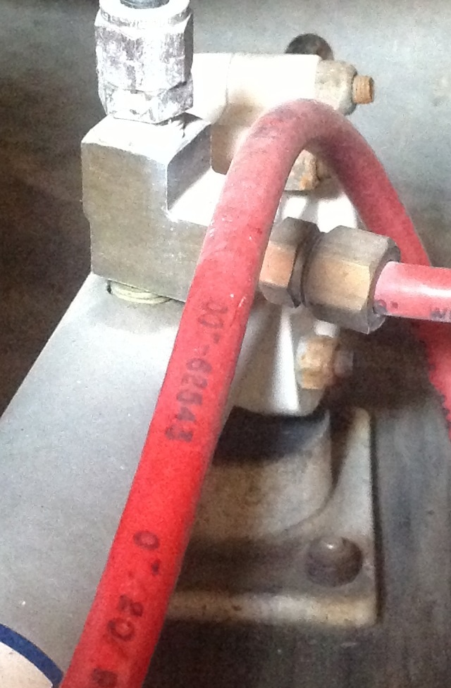

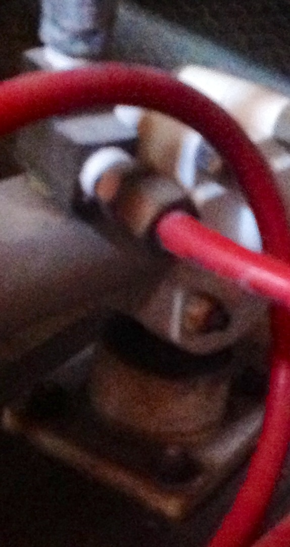

Update----------I checked all the measurements and the toe setting appears to be ok-----while jammed in the lazerette I noticed the steering ram has a good 1" of lateral play.There is a white mount of sorts holding the ram in place that seems worn out---- maybe has a ball and socket??--- will try to get a pic on next visit to send to Bob---
the ram is syten BA125-7-BJ.,rest of system is sea star --- thanks for all the responses--- Mike

A couple of pics of the offending mount---I know I posted these separately but maybe with a little history would be better-- Mike

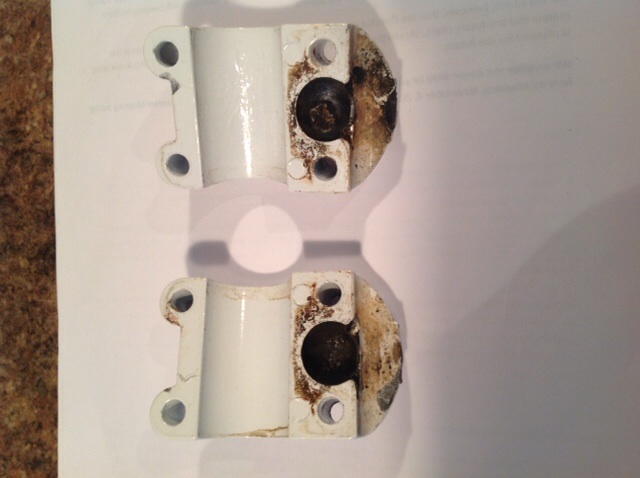

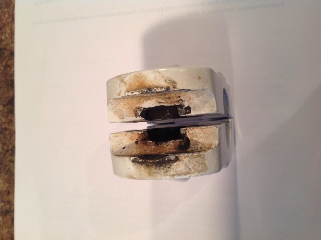

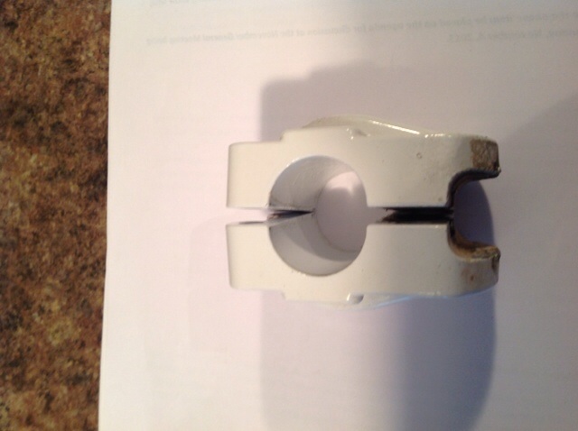

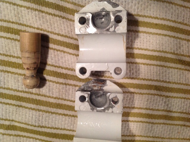

Another update for the steering issues---- this is the offending culprit giving me all the steering slack---- May not look like much but the holes the ball fits in are wallowed out and I think the ball is a bit smaller( have to measure ball yet to get accurate size)----- any ideas out there--- I know I could put a new ram etc down there but nothing leaks a drop at this point and there is auto helm connected as well----- Mike

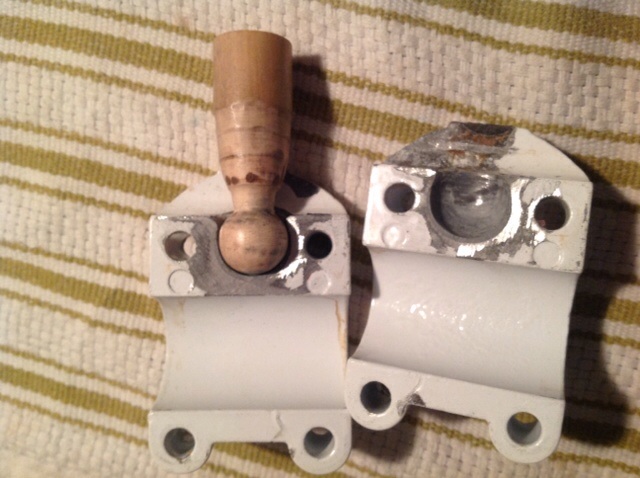

Another update for steering mount---- I made the wooden peg as a guide the same size as the one in the boat about .010" larger at .685 and then epoxied the holes and then fit everything with dremel and round grindstone---- fits now with no slop
