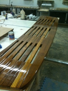

I've done a lot of varnishing and I'm still not to the level that I would like to be but here is what I've been told by the pro's to do. 2 of sealer, 4 coats on exterior, followed by 4- 8 coat of straight varnish. The pro's add 333 brushing liquid to the varnish but I can't seem to keep full coverage when I use it. When ever possible lay the wood flat and varnish it before installation, this will prevent runs and you can lay it on thicker. Sand between the sealer coats and the first couple of coats of varnish and use a green pad between the rest. Just a scuff, 220 minimum. You can hot coat the sealer if you wait about 2-3 hours and always give the vanish 24 hours between coats.
Try a practice piece first to learn how to pull the varnish on the wood.
I just finished varnishing the panel and decking below and they came out like glass, everyday after work, scuff and a coat.

Summer storm,
Those pieces look awesome...Nice work

Todd P, yes it's gloss. I like the satin finish too but gloss on the flooring seem to make the boat "pop". I used 2 coats of sealer before the varnish.
Todd B, thanks, it was a lot of trial and error.
