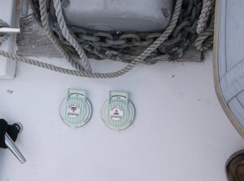

I just added 2 foot switches on the bow for the windlass . Took about 30 minutes .

Nice.
But how long did it take you to decide where you wanted them? I know if it were me, it would have taken a month of just thinking about it.

Unlike the transom door that took years of thinking about it , I did this on impulse .I found a deal and bought them was even looking .

Did you take pics? As you know I have the same Good Winch, show your wire hookup ans such..

Re: quick project (for a change )
Just the one photo I posted . Wiring is simple , the red wire from each switch to power , then the other wire from each swith to the small "triger" termal on the solnoid(s )

No doubt it was ez..but a picture is worth a 1000 words....
prowlersfish wrote:Just the one photo I posted . Wiring is simple , the red wire from each switch to power , then the other wire from each swith to the small "triger" termal on the solenoid(s )
Just to make it clearer the other wire goes to the same termals that the helm switch uses .
If i have my camera with me next time I can take a shot , not much to see just some solenoids and wires .
