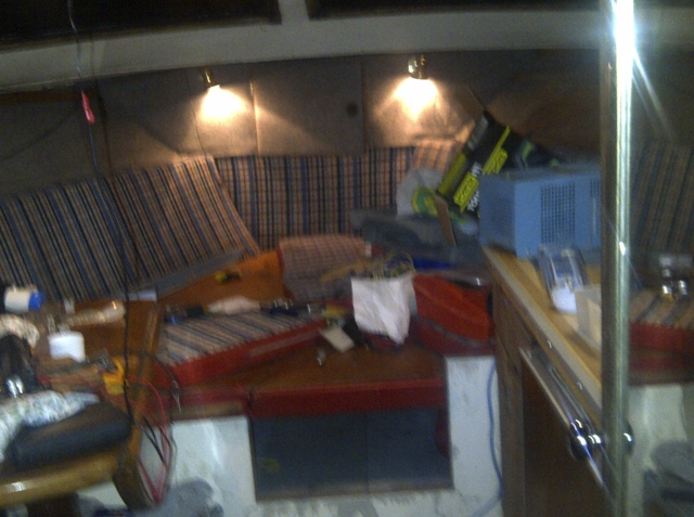

Interior lights , well ,
way previous owner had it set up was from fuse box basic house wire(not sure why he used heavy house wire but ohh well ) to bathroom from bathroom light to light above sink and across to light above table and in between those two he had a hook up for horn .. now for some reason he had wires in bathroom cut just before light and taped up with electrical tape not connected . Don't ask no idea :( ripped all that out and used basic red for power black for ground wire and added two lights in bunk area and took out horn wires as they going to be separate ,... and now they all work .. but damn that was pain to trouble shoot. Specially when new to it . I know some basic and some common sense but I bet took me longer then would electrician lol
Lights are on
Lights are on
Yes there is stuff everywhere buts still working on this and its getting close to that time that I can start finishing up all these projects and get it ready for survey :)
