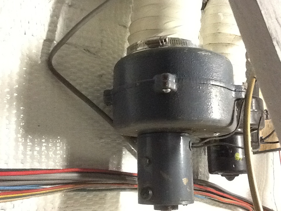

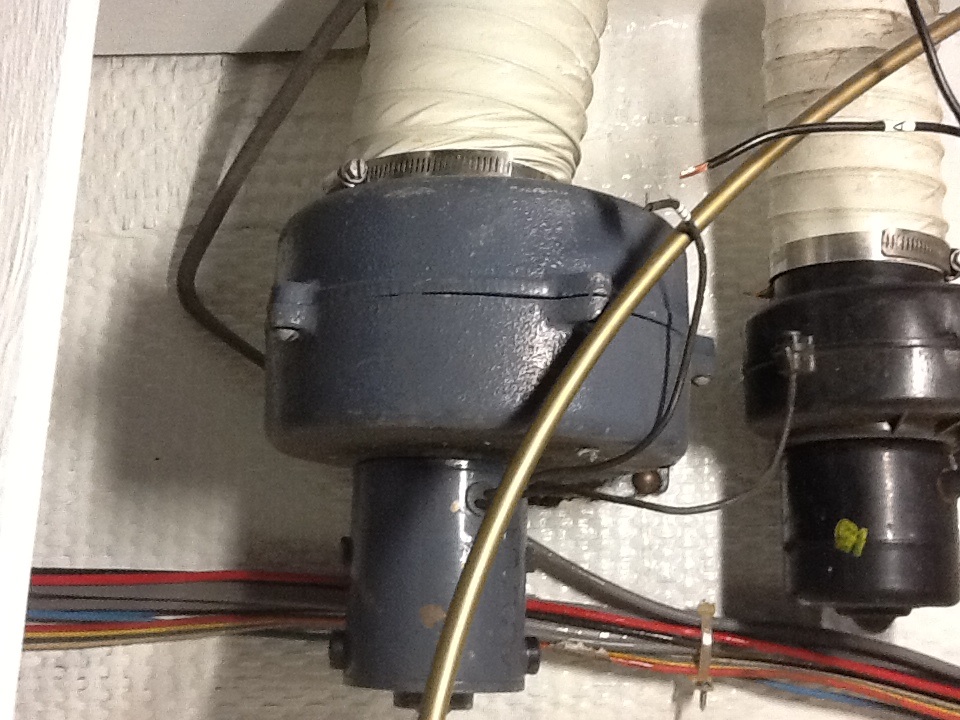

The PO just cut the wire to the 4" blower on my F32. I put power to it today and it is making quite a racket. Sounds like a bearing maybe. Has anyone worked on these or should I just buy a new one. This one looks like it is made out of very heavy material, nothing like you would get in a new one. Any suggestions? I do not see any name or model number on it.

I have the same set up. My big one just died.
I am replacing it with smaller one as there is a small one there already.
I have never ever seen those big motors in marine catalogs or on marine sites.

Looks like our set- up as well----- wondered about the sound,ours sounds like a jet on take- off--- maybe that is normal--- looks like a fairly substantial unit though--- Mike

The brushes are available for these motors, and they do need to be changed from time to time. There are also oil ports on them to keep them spinning nice and quietly. Really not too much to go wrong here. Long lasting and reliable setup. The 'small' motor Dave mentioned is the head vent, not the bilge blower, and that is why its a smaller motor. Use the proper one if you need to replace the one(s) in your bilges. If you aren't moving the proper amount of air (CFM), you are basically fooling yourself into thinking you have removed dangerous fumes.

Where are the oil ports? Mine seem to be completely sealed. I'm sure a shot of oil would do wonders.
BTW the smaller unit is the forward blower in the engine bay on my F32. 1 small (150 cfm) forward and 2 large (250 cfm) aft.

I removed the blower today. It is a Sutton Manufacturing Corp. blower. I found a phone number on the web, but it was too late to call today. There is a label that was next to the hull. I do not think that it is the brushes, but rather a bearing problem. When I spin it by hand, it feels like a worn bearing. There are no oil ports on mine. The link posted above for the flex blower is for a 120 volt AC blower. This one is 12 volts. I am going to take it home to Tucson and have the motor rebuilt.

There should be at least a stamp in the housing with an arrow for oil if theres not a port. Might have to look closely.comodave wrote: There are no oil ports on mine..........
..........I am going to take it home to Tucson and have the motor rebuilt.
Good plan. I was going to suggest a good electric motor rebuilder, but didn't know if things had gotten that far for you.
