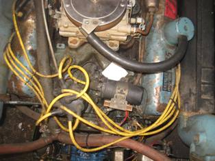

Fire order for 318 ?
So took distributor off to match up new one .. I did mark wires but ink didn't hold up well.. anyone have idea of order , if top left plug is 1 and across is 2?

For clockwise rotation engine the firing order is 18436572----- for ccw rotation engine the order is 12756348-----rotation viewed from the front of engine--- someone can jump in but I believe marine engines are viewed from the bell housing end--- anyway that will work so long as you know which way it rotates viewed from the front---Mike

Big D I am new to marine world but do understand it is marine engine . . To me where belt goes would be front or top like in car . I kept the wires in place on engine and marked the ones on distributor , 3 out of 5 ink didn't hold up well ..One way would be magnify pic and trace that way as that pic is correct for that engine

as a help when stabbing the distributor in you will see a slot in the top of the distributor gear. It should be lined up with the number one cylinder when it is at top dead center on compression stroke and that is true of either rotation.
