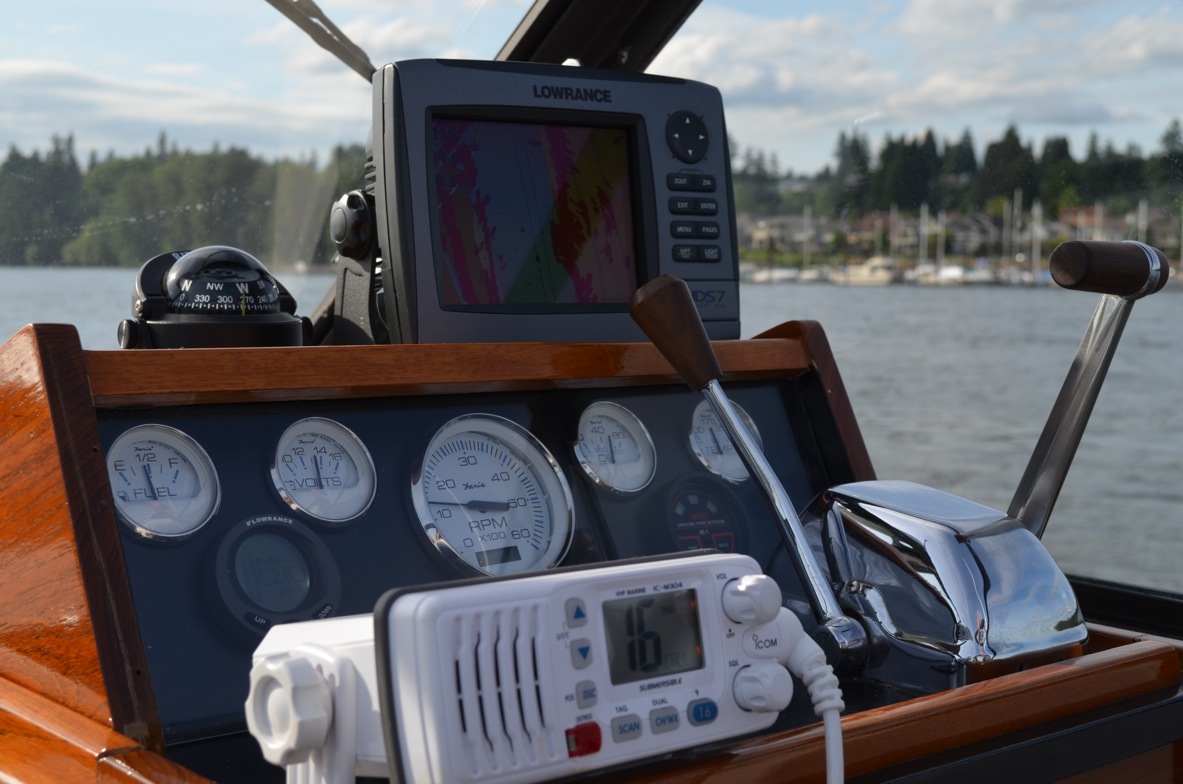

The gauges were mixed and looked like this.
I replaced the gauges with Faria Chesapeake White SS gauges (American Standard).
After replacing the gauges the status was this.

The only thing left was the fuel guages. With the American Standard gauges, 1/4 F was full and F was 8 gallons remaining (they worked backwards). Replacing the fuel tank senders would be much more difficult than replacing the oil pressure and temperature senders. The American Standard resistance values for fuel gauges are E = 240 ohms and F = 33.5 ohms. The European Standard resistance values for fuel gauges are E = 10 ohms and F = 180 ohms. Assuming a linear relationship I calculated that 1/4 F on the American Standard gauge was equal to 178 ohms. This led me to believe that the European gauges would work for my application. I installed two European Standard gauges to replace the American Standard gauges.
The only difference is instead of an E and a F they have an empty circle and a full circle. I guess this is because of all of the different languages that are spoken in Europe.
The gauges are no longer working backwards. They go the correct direction. 3/4 F is full so they don't work perfectly. 1/4 F is 10 gallons remaining, so I believe that each 1/4 is equal to 10 gallons but I don't have that much experience yet to be sure (I have 30 gallon tanks). I believe E will equal empty but I probably will never test it to be sure. While not working perfectly, the gauges are working close enough for me to be happy with the outcome. It was much easier replacing the gauges than replacing the fuel tank senders.
That's the summary of my gauge replacement adventure. My boat now has functioning gauges that allow me to feel comfortable when I'm on the water. If anyone has any questions feel free to PM me. I learned a lot from this project and I'd be happy to share any wisdom I gathered.
