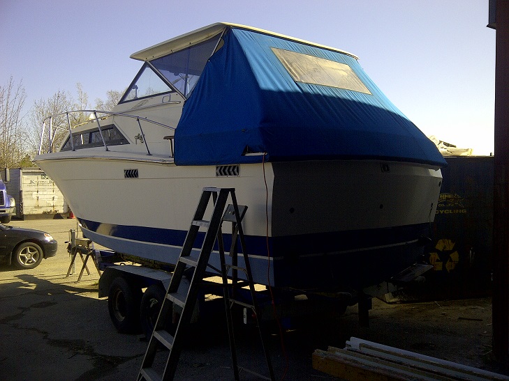

Winter house came off today and good clean up as well .. Tommorow antifoulin paint on bottom
- Bimini top on
- resize 3.jpg (140.03 KiB) Viewed 4571 times
