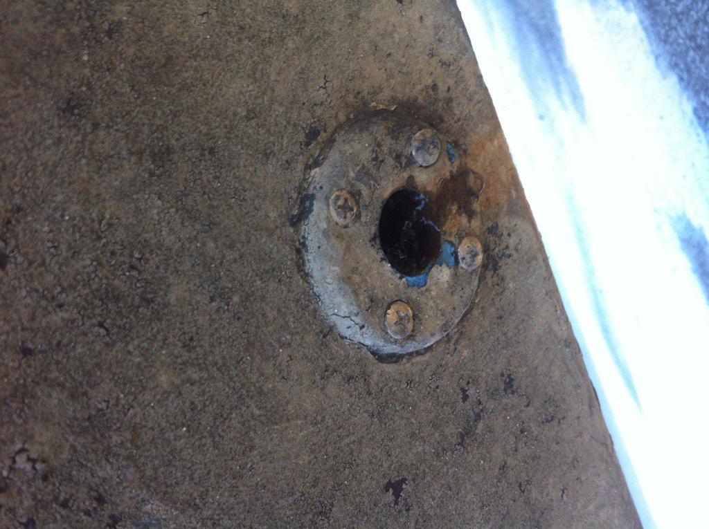

2) I need to replace 2 of the bolts that hold the metal disc were the drain plug threads in to in the front of the boat as 2 of the screws appear to be bent, Is this as simple as take the 2 out and replacing with new ones or should I take the whole assembly out , if so what is the proper way to re seal it. ( sorry for my lack of proper terminology )

For the drain I'd need to see before I could advise.

2) Replacing these screws might be as easy simply installing new screws with sealer. These screws don't usually come loose on their own so be sure that the holes that they thread into aren't stripped. If they are, you may want to remove the plate, drill out the holes then fill them with epoxy. Next, locate the plate and drill new screw holes and be sure to use sealer when you re-install everything.

Here is a picture of the drain in question. They look to be machine screws with a nut on the other end. 2 of them are bent on the other side , not broken off just wondering if i could just replace the 2 or leave it ..

If it were mine I would totally remove, clean up and re-seal it with new bolts. Also on the prop double check the shaft size when you check the keyway.

what is the process to re seal it , as for materials ?

Either 5200 or 4200. Seal unit prior to reinstalling into hull and seal head of bolts and part of bolt shaft at head of bolt. Give water NO chance to enter into/thru the hull.
