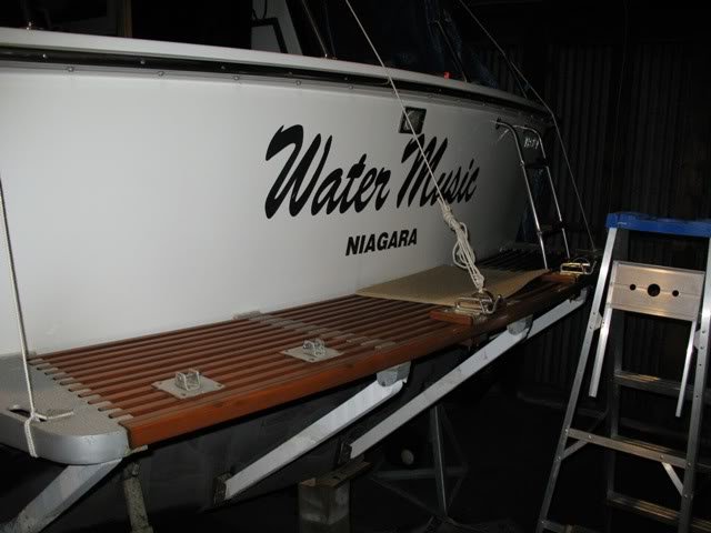

What platform style do you have? Is it like this?

Hi there---- the supports on mine look to be the same size and locations, only they are wood of some sort, maybe teak I hope. The platform is all wood from one side to the other with no metal except the rub rail around the edge, Wish I had some pics but have not had boat long enuf--- Mike
Re: 78 f32 factory swim platform
Ok... so I think yours is more like this one then... You will have to get info from one of the other folks here (including the owner of the boat in the picture!). If it helps, on mine the supports are wood - oak I think.
You got it !!!--- that is just what it looks like, or should I say will look like , if I can get it off--- that is also very nice script on the vessel name---- good job on the pic finding, thanks -- Mike
