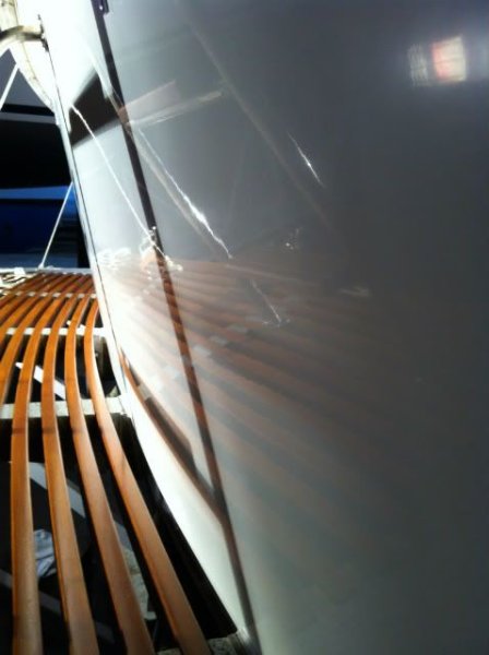

Well, after last year of trying just about every polish out there, mucho $$ and much aching muscles, I could NOT get the Hull to shine like glass. Some of the repairs that were done to the Hull, would just not come nice.
So... this year, after researching, and trying out the product on an oxidized piece of Fiberglass at the boat show, I was impressed and couldn't wait to give it a try. And yes, it is Poli-Glow.
First I cleaned it up with the cleaner they provide, then started wiping the wax on, easy as running a wet cloth. Product goes on wet, and dries very fast. The time it took me to get around the boat, the 1st coat was dry. I put 7 coats on, took me all of 2 hours, with the drying time, to wash, just mild soap and water. And, I still have half a bottle left for next year if necessary.
Rooferdave can attest to the results, as we are both members of the same club and he saw the before, and the results that I have now.
I also added the Red stripe between the Anti-fouling and the newly replaced Gold stripe.
here are the results, as promised....

Looks great

Good looking job.

I have been using poliglow since I have had my boat and ihave been very pleased
I think you will too. You'll also notice getting dirt and bird droppings will hose off and leave no marks.

Looks awesome to me!!!!

Looks real nice!
I have heard from a few people that you should not use any harsh cleaners on it. Just use soap and water. The couple who have a boat like ours used it on their boat but when they used some grey streak remover, it took the shine off from their boat.
Just take care of it and it should look nice for a long time. Looks great!

.....Needs a couple more coats........
LOL! Looks GREAT!

wow that does look nice, imana have to try that on my boat, it could deffinately use some shine

Vitaliy wrote:wow that does look nice, imana have to try that on my boat, it could deffinately use some shine
Just make sure you follow the directions, and if you are going to do topside, make sure it gets done first, otherwise the cleaner will run down and remove the wax job on the hull, and you'll have to redo it again.
1st coat is a bit streaky, but as you add a few coats, it comes out all flat and shiny.
It looks great, I am happy with it. And my 32 year old boat was impossible to bring back to a shine with anything else. I tried them all. Believe me, had the aches to prove it.
Karate Kid, "Wax on, Wax off" sucked.
