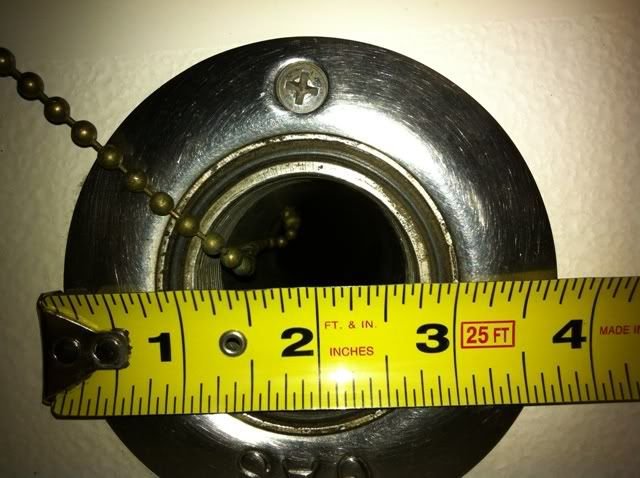

Wow! That was fast! Thought it would take at least until the morning to get responses. I don't think they are Perko (at least not the same look as the pics posted).. as they are original equipment from '79. I will take a pic tomorrow.
K9th.... is it likely that the number will be printed on the ring somewhere? I can try pulling one off I guess (haven't wanted to disturb them in the past in case I split it). Rough measures are 2" ID, 2.25" OD (meaning I guess 1/8" cross section) from measuring tape a while ago.

That's a very common size and I can send you some if you want. There will not be a number printed on the o-ring in all likelihood. The cross section and diameters you listed means its a -226. PM me your info & I'll send a few your way on Monday if you want.
If you want to get some locally make sure they are buna or nitrile and give them the dash number. If you want viton, they're more expensive but better quality. If you're measurements are right or very close, it should fit OK.

Man, appears my numbers were way off before, and my pictures today suck.... Gotta retry the pics when I have more time, better light, less beer in me, and can align the phone/camera and tape to eliminate the parallax issues.
Anywhere from 1 3/4 to 1 13/16 ID, with 1/8 cross section I think... but gotta re-check.

Looks pretty close to 1.75" ID so that would be a -224. If you want me send you some, PM me with the info.
