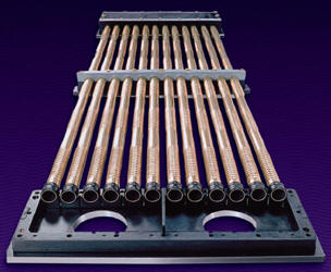

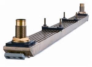

You maybe raw water cooled (uses lake/bay water ) or fresh water cooled ( antifreeze w/ heat exchanger)
But I highly doubt You are keel cooled . A keel cooler uses coolant flowing through tubes or a exchanger that is mounted under the hull in the water . As a general rule they are not used on Planning hulls .Its a safe bet that Trojan never used them on a F32 .
keel cooler.jpg (7.18 KiB) Viewed 8471 times

Diverted Income wrote:....(keel cooled) raw water cooled......
Two completely different things!

I added keel cooler pic to my post above
