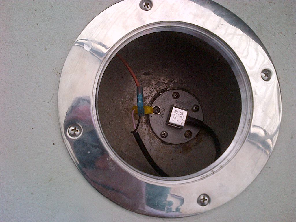

I have put up with my fuel sender as long as I could. I am taking RWS's advise and cutting an access to my sending unit. Does anyone know the specs or model number for my 1983 10 meter's sending unit? What size deck plate do I need to install the new sending unit. I'm looking at a 5" stainless deck plate on EBay.

Thanks for your help RWS. It was painful to cut a 5" hole into my rear deck. It will be worth not filling up every other trip for fear of running out of fuel. I am replacing the connectors when I get back from West Marine.
- Fuel Sender.jpg (111.71 KiB) Viewed 7445 times
