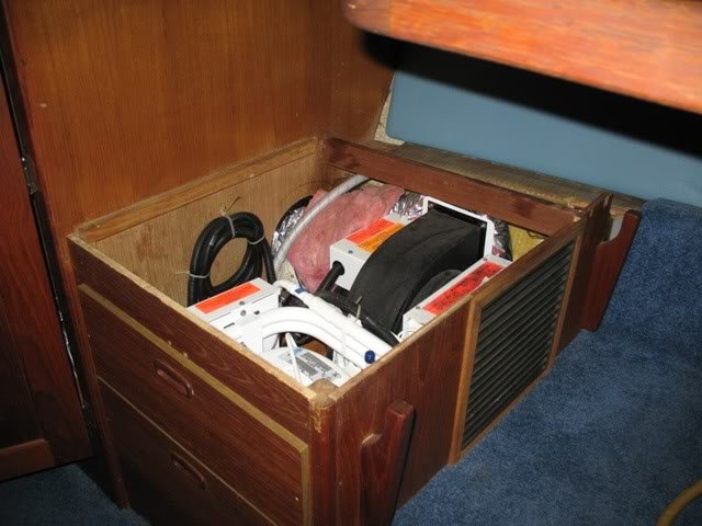

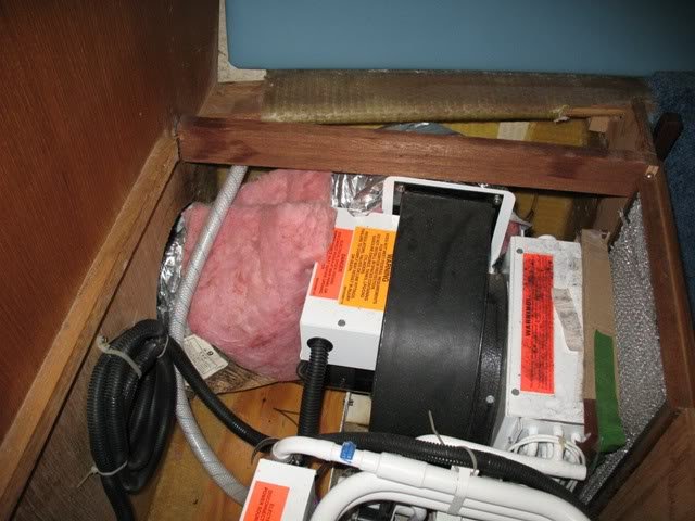

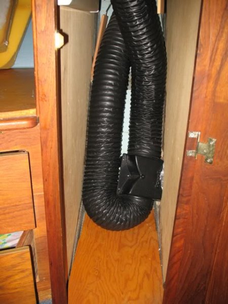

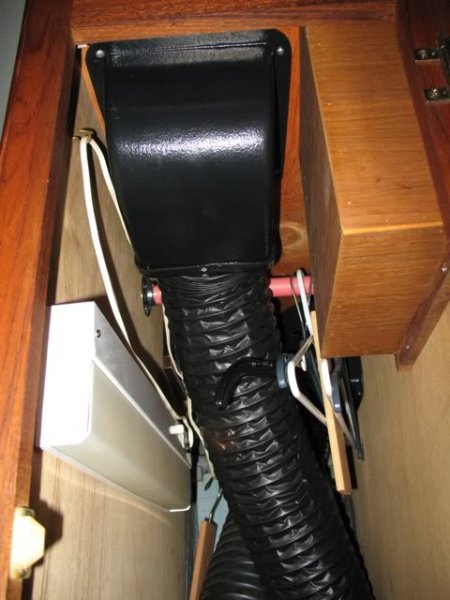

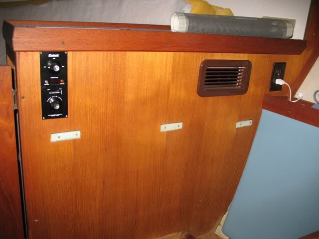

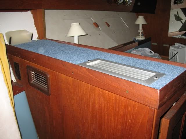

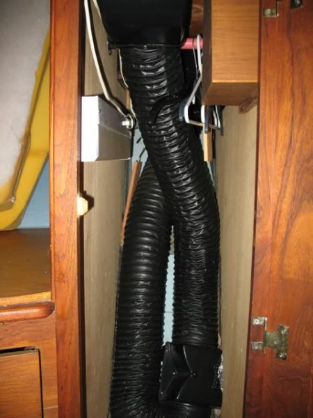

OK.... Here are the AC installation pics I promised. Let me know if you have any questions and I will do my best to answer them (installation was done by a prior owner). Pics are as follows :
1 - AC (Cruisair StowAway 12,000 BTU model) is installed under forward dinette seat. Thru-hull and water pump to feed it (and strainer) are back in the engine compartment and hose is run forward. Drawers have been removed, and drawer fronts are just screwed in place so everything looks 'normal' when the seat is in place. The white hose you see (with blue stripe) attaches to a thru-hull about 12" above the waterline for the water outlet. Oh yeah - it is also on its own 15A breaker. In A/C mode I am normally okay, but if I try to use 'heat' mode I often trip the breaker.
2 - Air intake through louvers under the dinette.
3 - Here you see the output of the AC (wrapped in pink insulation) ducted forward through the bulkhead, into the hanging locker.
4 - Up above on this bulkhead, aft side, are the controls and a vent. The vent is ducted, and blows air aft into the Dinette area.
5 - Forward side of the hanging locker, you see two more vents - one on the top of the shelf (ducted, blowing air up and aft), and one hear the hull side (not ducted - letting 'ambient' cold air out of the hanging locker and helping vent it, forward to the v-berth).
6 - Ducting in the hanging locker ... you can see the 'T' near the floor. This is what the duct wrapped in the pink insulation in the AC pic flows into. Two hoses off of this box both run upwards. Can't really see it very well, but there is a sheet of 1.5" styrofoam insulation between the hoses and hull side. Even with that, when I have the A/C running you can see a clear rectangle of condensation on the outside of the hull exactly where the hanging locker is.... so its cold enough in there to radiate outside... These hoses really annoy me - we basically lose half the space in the hanging locker because of them.
7 - One of the hoses runs upwards and then out from the hull side to feed the vent that you saw on the top of the shelf in pic #5. The box you see to the right is the back of the A/C controls being boxed in. Highlighting one of my annoyances with the loss of space due to the ducting - the pink thing behind the hose is the rod for hanging stuff on.. So we get about 3 or 4 hangers in here tops (2 of them for our inflatable life jackets, the other two for infrequently used rain gear).
8 - Another shot of the mishmash of hoses, in this one you can see the hose that disappears in the background - this feeds the vent that blows into the dinette (shown in pic #4).

I have an idea about gaining some (not much) of the space back in your locker. Is it possible to make a 90 degree turn up with just one duct where the duct comes through the bulk head (opposite the pink insulation) and then install the duct 'T' at the top of the locker and then run to the vents. This way you only have one duct running vertically in the locker (more space). You might gain some air velocity with less amount of duct length also. Also, it's unclear if there is a tight bend in the duct coming right off the blower. You might be able to find a 90 degree flanged piece to attach to the blower so you don't get so much air turbulance right out of the unit. Just something to kick around.
Thanks a gain for the photos and the decriptions. The unit I'll be installing is only a 5000 btu unit so it might be struggling on some hot days, so I'm gonna try and be right on with my duct work in order to get all that I can out of the unit.

Glad the pics help. Re the idea of rerouting the ducting - might help a bit, but I would really rather find a way to move the unit and reclaim not only the locker, but the drawer space as well. Will keep the idea in my back pocket though...
