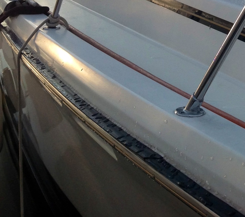

There is rubber with stainless on outside--had to crop pic to reduce size---- Mike

Re: RUB RAIL
Jmarkroy wrote:Mike that looks great! did you do it yourself? where did you pick it up at? how much did you need? AND did you have the teak rail prior? I know a lot of questions but thank you in advance.
Sorry on all counts it was on the boat when I got it--- I thought I would show you what the black looked like---- looks like it came in lengths because there are joints in it----Mike
