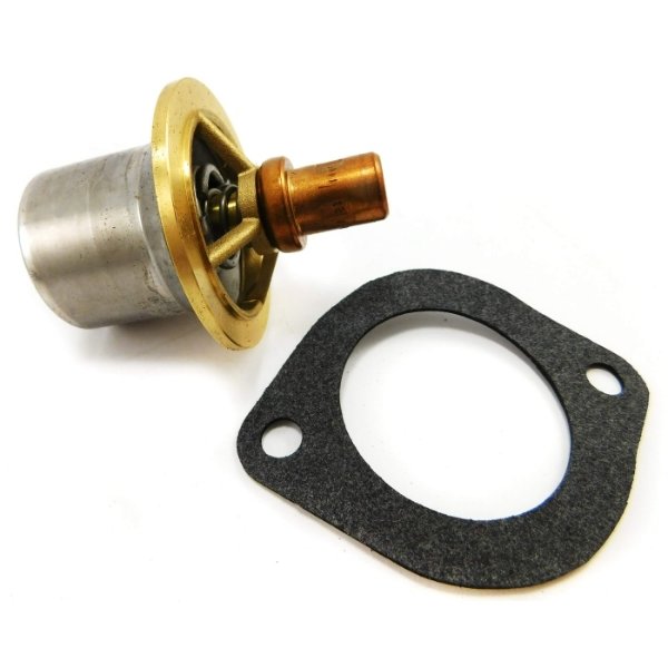

Re: 318 Chrysler marine engine overheats
Posted: Thu Jul 24, 2025 9:34 am
The 318 marine and automotive thermostats are not the same Most of the marine ones close off the bypass when they open
marine thermostat.jpeg (34.52 KiB) Viewed 4012 times
Do you have a photo of your housing?
