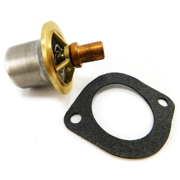

Re: 318 Chrysler marine engine overheats
The 318 marine and automotive thermostats are not the same Most of the marine ones close off the bypass when they open
marine thermostat.jpeg (34.52 KiB) Viewed 3997 times
Do you have a photo of your housing?
