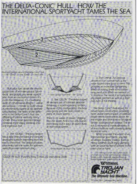

Delta Cronic is the name of a hull design used on Trojan Internationals and the Trojan American. The boats range from 20'? to 14 meters ( close to 50') Any photos of what you're looking at?
