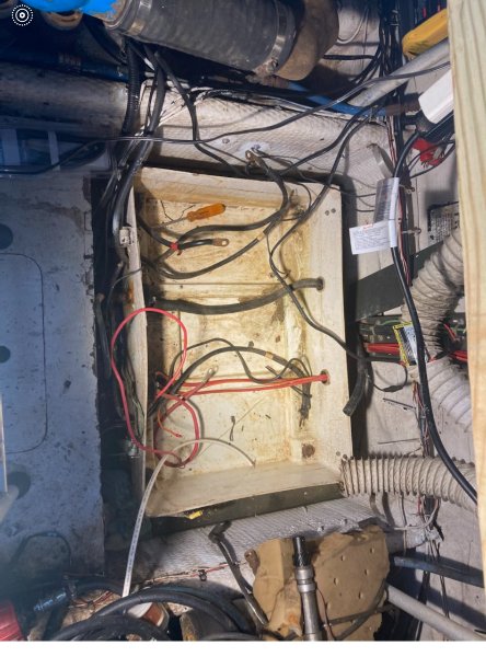

Starting Batteries should be group 27 and generator is 24. The box was molded for two 27s and one 24 As a general rule 27s have more power than the 24. I am not sure if the 31 would fit. Mrrudley did you have to modify the box for 31s?

Re: 1988 10M-mid cabin battery sizes
Prowlersfish,prowlersfish wrote: ↑Fri Dec 02, 2022 9:10 am Starting Batteries should be group 27 and generator is 24. The box was molded for two 27s and one 24 As a general rule 27s have more power than the 24. I am not sure if the 31 would fit. Mrrudley did you have to modify the box for 31s?
Does that battery box criteria also apply to a mid cabin? Because the pic shows a non-mid, perhaps an express?
my battery box looks like the photo
the 31's are about 1" longer than the 27's and about 1/2" higher
I had no problem getting the 31's to fit but I just realized the 24 is probably not being held down properly
Yes I checked on the mid cabin and It's supposed to be the same box as a mid cabin. I will double check. Not an express for sureScott67 wrote: ↑Fri Dec 02, 2022 11:12 amProwlersfish,prowlersfish wrote: ↑Fri Dec 02, 2022 9:10 am Starting Batteries should be group 27 and generator is 24. The box was molded for two 27s and one 24 As a general rule 27s have more power than the 24. I am not sure if the 31 would fit. Mrrudley did you have to modify the box for 31s?
The photo is indeed from a mid-cabin. FWIW The express is a liner boat and you can tell that's not.
