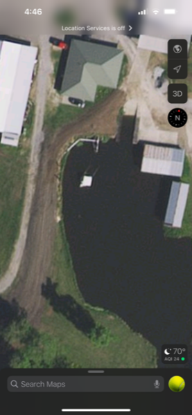

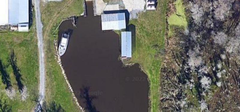

ok i can not found anything on a F44 sportfish twin VT903T in it :( .. other then .. he say :x ... if you have owned one plz post a picture ... I have just come into one that we are going lift up out the water on 9/23... power lost and rain boat went under ... i was just trying to see why i cant find this boat anywhere other then sells papers or a write up from 1976 :?: ... i am starting this post to show the boat as we get it back up and the damage from being in the water for so long ... so lets start a friendly bet lol ... What you think Think this boat can be saved ...

Any boat can be saved throw enough cash at it. Salt or fresh water? how long has it been down? Likely looking at a repower unless it's a short time and you get the engine pickled. Pulling it on 9/23 is a long time how long has it been in? Have any photos now In the water ? I know some things about these feel free to ask. What I don't know I can find out most likley.

prowlersfish wrote: Sun Sep 11, 2022 9:17 am Any boat can be saved throw enough cash at it. Salt or fresh water? how long has it been down? Likely looking at a repower unless it's a short time and you get the engine pickled. Pulling it on 9/23 is a long time how long has it been in? Have any photos now In the water ? I know some things about these feel free to ask. What I don't know I can find out most likley.
Yes we have did a number of them and know about what needs to be done ... But never a Trojan and this size and underwater for this long ... The guy got sick right before the last Hurricane in La, ... They just want it up and out so we made a deal to get it moved for them ... From what they said and are getting together is all the original paperwork on the boat .... and yes on 9/23 ... The boat has all ready have been under for a good min and it is in fresh water ... In this particular situation we are not just jumping out there to get it done because it's been under for this long ... no point in paying the guys more hrs to run out there on short notice ... and I will edit the first post adding the two pictures I have right now ... what got me thinking and posting on here is that :arrow: I can't find this boat this size this year anywhere ... like it never existed :?: ... I would post the papers we have on it but that will be a little later ...

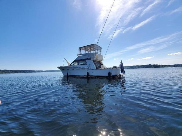

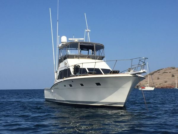

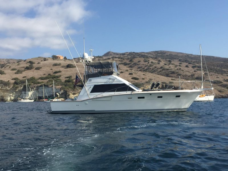

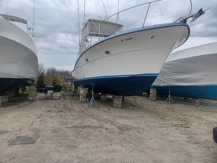

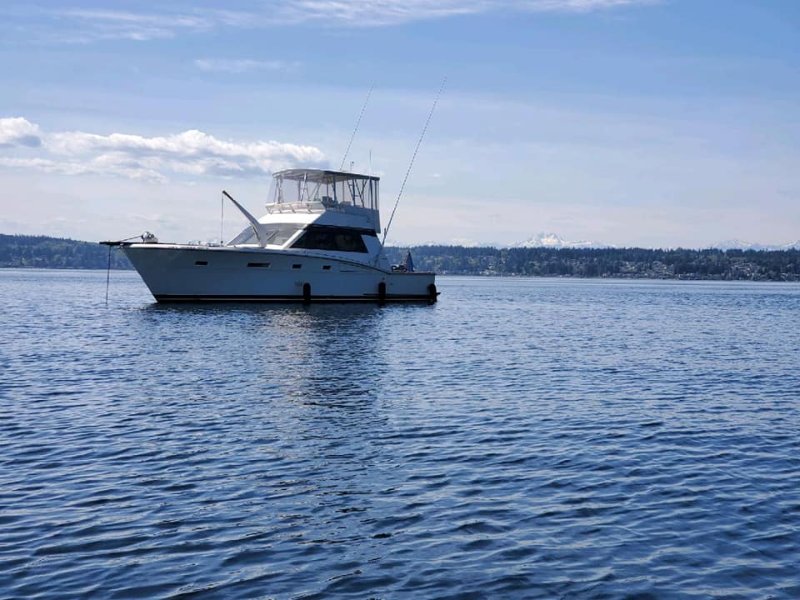

Here ae some photos of 3 different F44s that are in use.

prowlersfish wrote: Mon Sep 12, 2022 10:58 am Here ae some photos of 3 different F44s that are in use.
Oh nice they are beautiful boats :D ... big as hell haha ... BIG Thanks for the pictures i have not seen those ... You would not happen to know what year's those are ? ...
Re: 1975 Trojan F44 SportFish
DanF44sportfish wrote: Mon Sep 12, 2022 4:21 pm
75-77 or 78 I think. The one on land is the newest I believe I I remember I will check.
