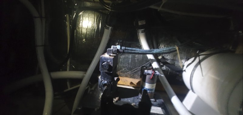

Thanks for the reply. I checked the engine room under the helm hoping to find where the genset was connected, but no dice. The few visible wires had routes of their own. Looks like it is time to remove the panel and start from that end. Hopefully I find them tucked away.
Engine Room.jpg (37.71 KiB) Viewed 4432 times
Re: Switch for inverter/shore power
Trojan had a breaker between the generator and the pannel. Not a bad idea. I don't get why anyone would remove a generator. An inverter is nice but has major limitations.
