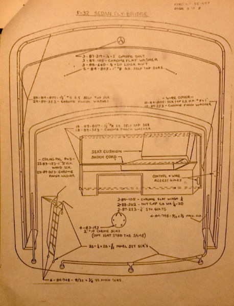

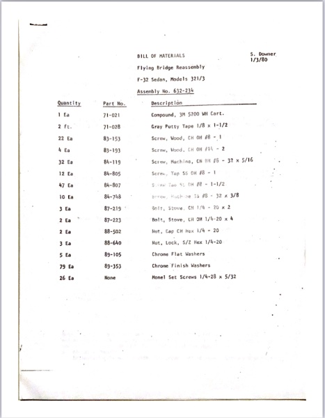

Also shared to the FB official group but figure I’d put here for posterity too…
F32 flybridge re-assembly instructions: Hadn’t seen these posted before so apologies if they have been, but I found this while rummaging thru the old docs in the original boat binder. Thought it might be useful for other F32 owners to have in their files and to just have documented somewhere. Also happy to send a pdf copy to anyone who wants. I don’t recall it being part of the manual Beacon Marine sells, otherwise I wouldn’t have shared publicly.
For now I’ve got it for download at
https://drive.google.com/file/d/1-Nzb-z ... Z--hFZ-XQ0
