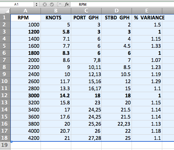

I have attached the results of the most recent sea trial
there may be a leak down test in my future

Check your timing with and without the missing spring. You say you swap carbs with the same results? Is your fuel burn difference conferred when you fill-up? Fuel on the water only at idle speed? The thing I find odd is the big difference at some rpm and a match at others. Let us know what happens with the spring.

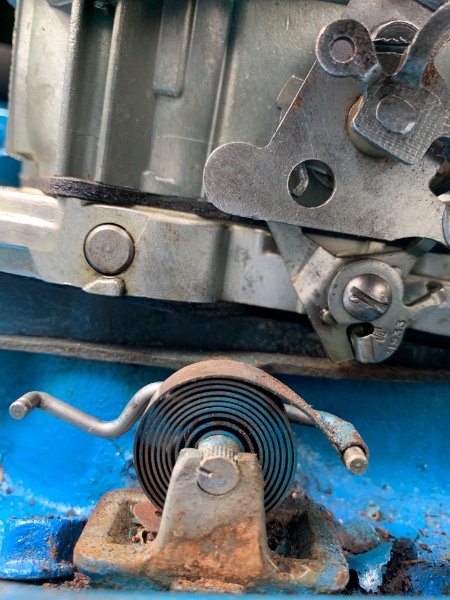

Re: 89 mid cabin fuel consumption
I removed the choke coil from the port engine
and removed the choke coil cover from the starboard engine
it seems as if it was the starboard choke coil is the one that I may have stretched out (not the port) thereby keeping the choke
somewhat open when cold
so my explanation was not accurate
however I still believe the problem was a tightly closed choke (on the port engine the problem one)
so my question is where would that condition come from
and how can I best correct it?
rr

You can try replacing the choke coils or adjusting them. I have always hated chokes on a boat. over the years I set some very loose, and disconnected some. Just need to warm up the boat a bit before going out. Do you have a photo of what choke style you have?

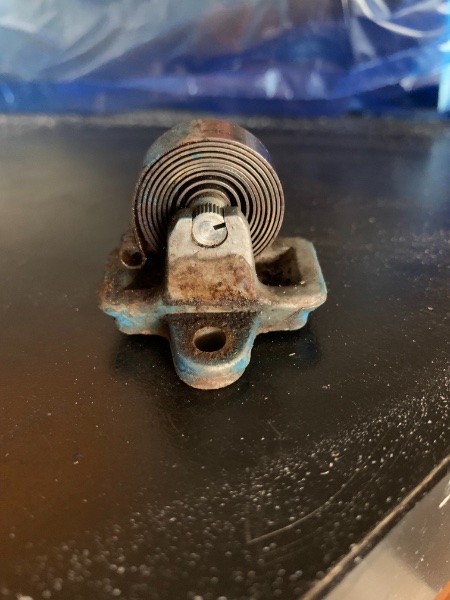

I am attaching a photo of the stretched out starboard choke coil
and the wound tight port choke coil
The starboard coil binds up in its housing
I have not been able to get it off yet
I hope to straighten in out
I am thinking of lengthening the linkage on the port side so it will start out leaner
thx
rr
there seems to be left and right versions of those choke coils
also crusader has two part numbers listed, one for 0 angle and one for 12 degree down angle according to a post I found on another forum
today I started both engines without the chokes
no problem
that's the solution for now
thanks everyone
rr
