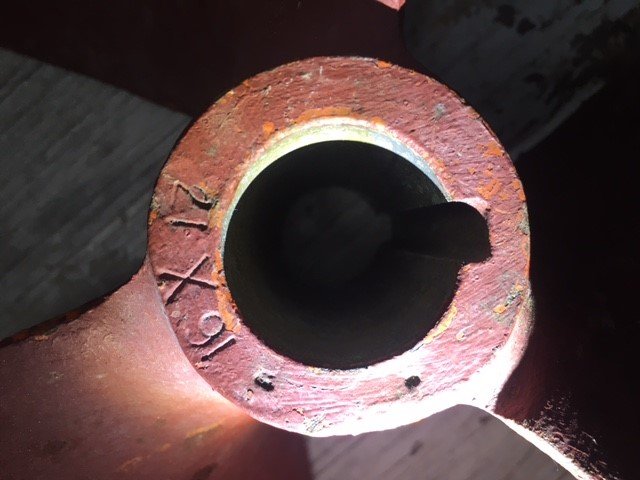

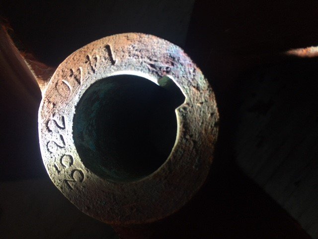

I've attached the size and numbers that are currently installed, they are three bladed. I have to change the propellers as galvanic corrosion has gotten the best of them. Looking for anyone with the same boat (model) that has done any changes in the size/pitch/blade count of their propeller and what your feedback is. Not looking for performance numbers, not looking to "go fast", just curious of general comments about the change and some of the reasons that led you to changing your propellers. Some folks have gone to 4 bladed, but haven't really heard why.
