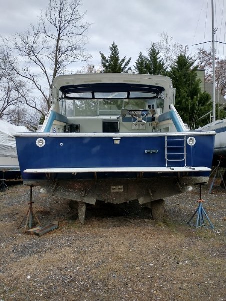

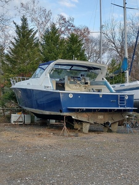

Yes, there is a small water-filled baffle next to the generator. Engines are seized, I can't manually turn them over. I was thinking of removing the injectors to pour a penetration spray in the cylinders and let them sit a day. Either way I'm pulling the heads so it probably make more sense to just pull the head and see if I can't un-seize her. I'm going to tear down to the blocks and will most likely remove them so I can remove the crank to inspect and replace the bearing etc. The Generator is ready to pull out, don't have much information on its condition but I was told it wasn't running before she went under.
Transome view 12-06.jpg (234.14 KiB) Viewed 7405 times
Stern Port View 12-06-21.jpg (254.36 KiB) Viewed 7405 times
