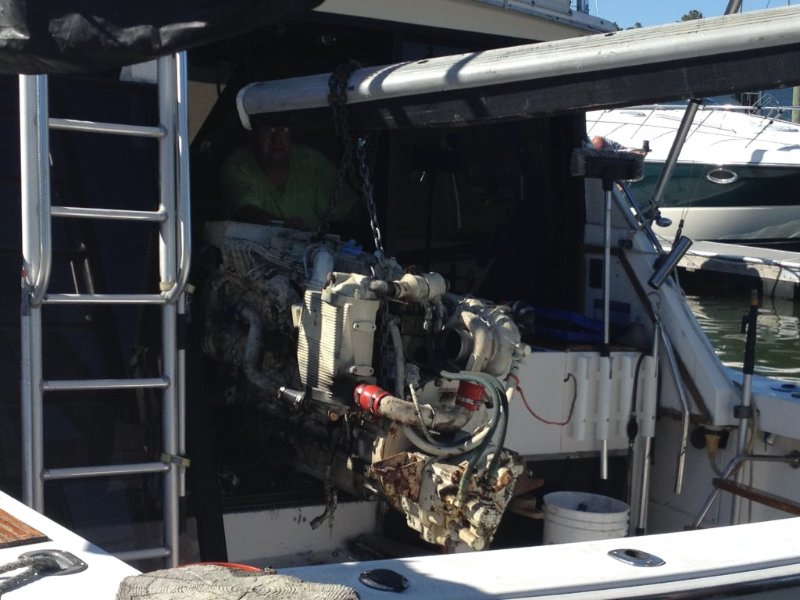

The will come out. Removing the door gives you an extra 3-4" No engine hoist fork through the door. Yes its an F36 and not 318s but the same removal
engine removal 1.jpg (82.37 KiB) Viewed 20679 times

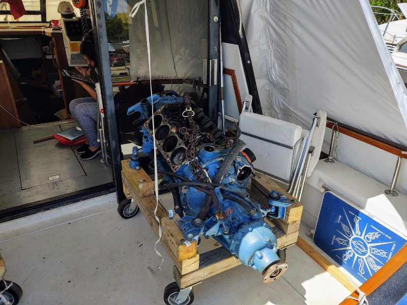

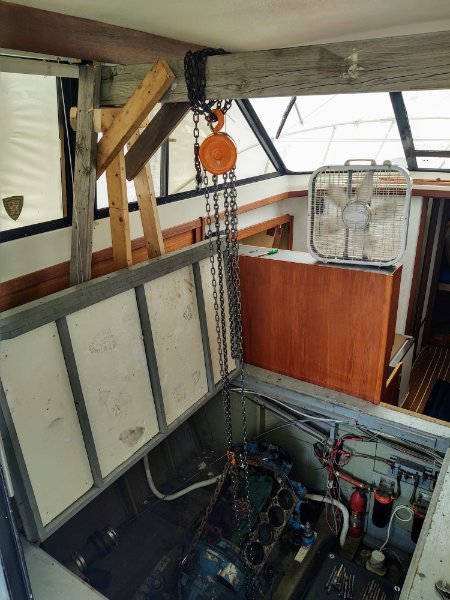

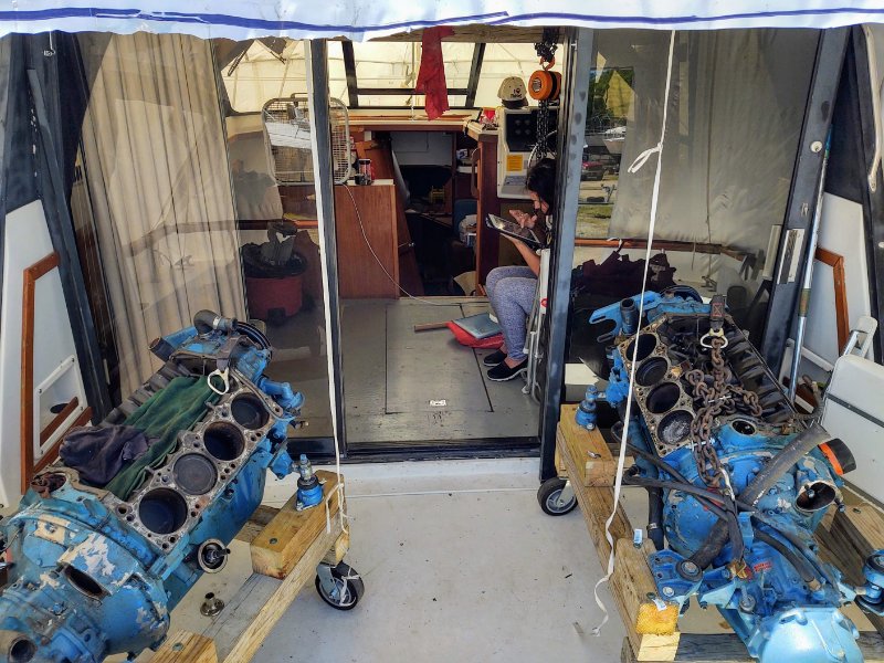

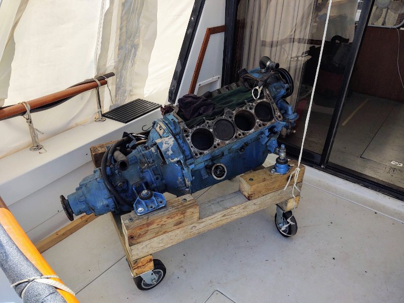

Here a few pics of my engine removal. I build a lift in the boat and cradles for the engines.
engines on deck.jpg (134.47 KiB) Viewed 17746 times
