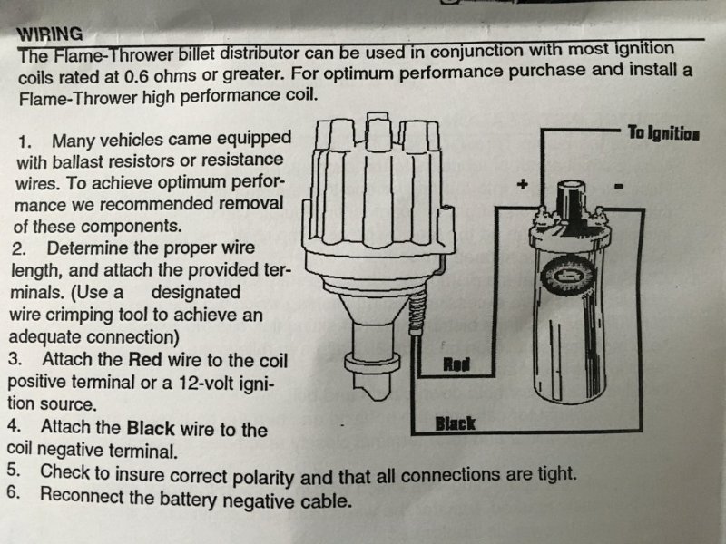

I installed the distributor and new coil. Can’t get it to fire up. Bypassed and removed the ballast resistors. What wires need to be connected to coil along with the wires from the distributor?

TADTOOMUCH wrote: Sat Apr 16, 2022 1:46 pm I installed the distributor and new coil. Can’t get it to fire up. Bypassed and removed the ballast resistors. What wires need to be connected to coil along with the wires from the distributor?
Make sure you have 12 volts to the coil + key on and cranking Did you hook it up per the diagram? If yes try disconnecting the tach wire .
