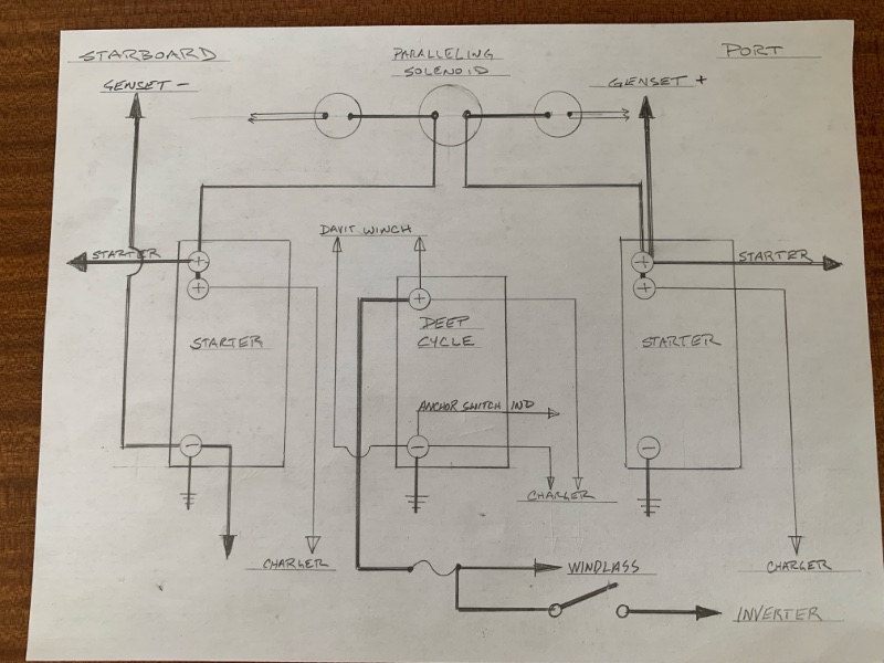

this has probably been covered before but here goes
I have two starting batteries and one deep cycle battery
It seems as if the original set up is to have the start batteries also serve as the house batteries
If so does anyone know the reasoning for this?
I'm thinking of having the deep cycle serve as the house battery
Would this be as simple as disconnecting the starting batteries from the breakers and connecting the deep cycle to both breakers?

The reason they used one starting battery as the house is because it worked. At least for most owners and factored in that the Genset would be used a lot. Got confused at first as you labeled the starting batteries as staters lol. I think when new you may have also had a generator battery also.
The issues I see with your setup are as follows. I see no charging of the house battery from the engines when underway. Also the windlass is normally run off a starter battery and used with the engine running.
What exactly are your house loads and how long? just overnight or days on the hook?

I went through the same process on my mid cabin but left the start battery/house setup as is but upgraded to group size to 31’s (they fit fine) and use dual purpose batteries to handle the house loads. The biggest draw is my cabin fridge so I installed a switch to share the load between the two batteries. After 7-8 hours I toggle over to the other battery if I’m on the hook overnight. No issue running lights (all LEDS now), head, TV’s etc.
In addition, I added a 3k inverter (no generator) and four 6v golf cart batteries. That’s dedicated to my wet bar fridge, stereo/amp, underwater lights and my 4000 GPH bilge pump. I also added a dedicated AC outlet in the cabin for coffee maker, toaster oven, etc., on demand and a panel switch so I can run my microwave. I’ve done this up to two days without an issue. Basically everything on the boat works normally except AC and stovetop. This is probably n/a for you since you have a generator but this is a good option for someone who doesn’t or has 1-2 day overnights and would rather not run it.
I have a pair of jumper cables in case I ever needed to jump from the house bank to a start battery but will probably never need them.

Alternator maybe 70 amps ? You really did'not say so i I am not really sure of your house load and bank size.

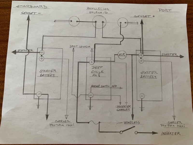

I have attached a new proposed wiring diagram
I moved the anchor windlass to the port start battery
I disconnected the port start battery from the breaker and connected the house battery in its place
I added a ACR (or battery isolator) joining the port battery with the house battery
I have the inverter charger connected to the house battery
I have the protect charger connected to the port and starboard batteries (using only two banks of the three available)
I don't yet know how big of a bank I need for the house but with this setup I think I can add as needed
Does the positive of the genset charge whichever battery it is connected to?

Yes the genset will charge the battery it is hooked up to. It is very low output.

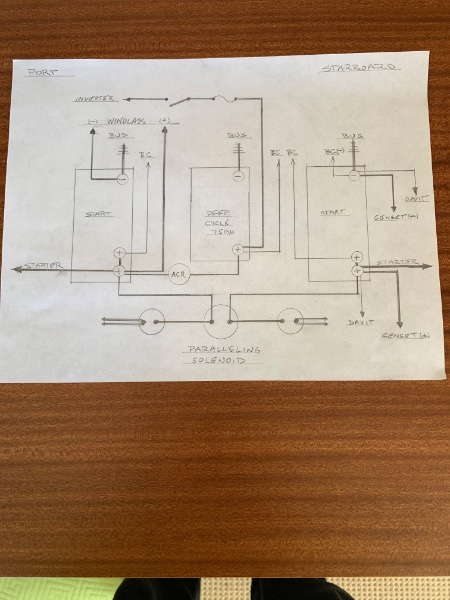

hey guys
here is my new proposed wiring diagram
I moved the genest to the starboard start battery
I came across the following in the manual and I am wondering what it means and if it is of any concern.
GENERATOR BATTERY:
"This consists of one or two 12 volt maintenance free batteries. It is used exclusively for starting and operating the generator and is recharged automatically when the generator is operated.
CAUTION: Do not make any connection to these batteries while they are connected to the generator, or damage to the generator will result."
My thinking is that the engine start batteries would be a good bet for having power to start the generator and I would then have a dedicated battery for my inverter.
Separately the port start battery runs the cabin lights so I am thinking that should be replaced with a dual purpose battery when the time comes.
Any comments would be greatly appreciated.

Suggest you check out deep cycle for your house bank not dual purpose but that’s just my opinion. Figure out how much your house bank needs by adding up the amps used per hour when nothing is charging that battery and get a deep cycle to meet or exceed that by another 25%
