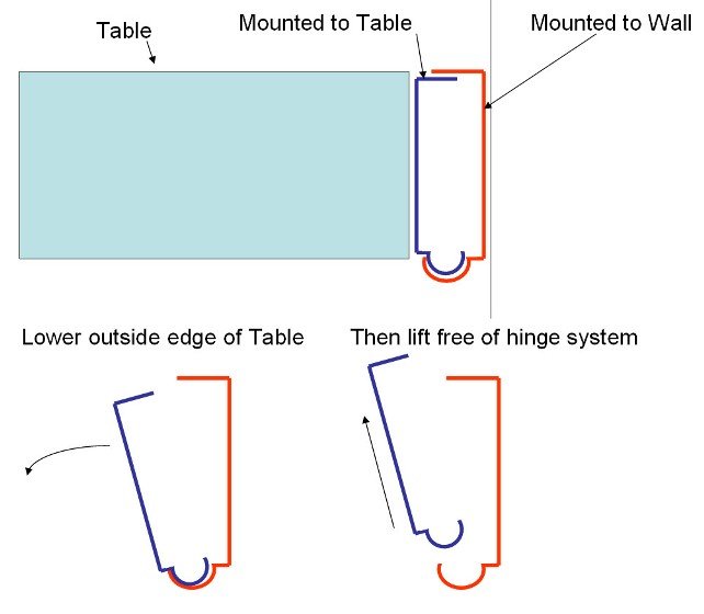

I had posted this a few years back but the picture appears to be gone from the original post... Don't know if it is the same on the Internationals, but for the F32 the 'hinge' where the table meets the wall works like this... To unfasten the table: fold the leg, lower the outside edge of the table until top of hinge / bracket clears, then lift the back edge up and out. To put it back, just reverse: with outside edge of table low, place bracket at back edge into the trough, raise outside edge of table to lock it in the bracket, then put leg back in place.
