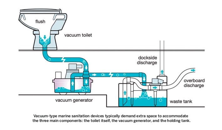

Never seen the triangle with! without a message. On to the Head On my boat and others, the drain switch is for the shower. But no telling what has been done here. I Don't know of any pump that is supposed to suck air from the outside. It sounds like your pumping the holding tank out and the air is getting suck in through the vent. Are hitting the peddle on the head? Here is a diagram of the Vacuflush system. It doesn't show it but there is a valve on the bottom of the head (foot pedal) Try to post photos again, If you still can't send them to my email. I will PM you, my address.
- vacuflush-system.jpg (39.35 KiB) Viewed 4405 times

I looked at that diagram and I noticed my holding tank is not vented. I have a feeling some one really rigged her up, the pump running to the “drain pump” is ran into port side out next to the engine. That a long way to travel, I pulled the filter and it was full of lint. Makes no sense to suck air that far and the funny think is there is still fresh saw dust I am making sliding doors for starboard side under windows. I got this boat almost gutted and have been playing the puzzle game with wood pieces. I’ll take detailed pics and get them on here. It’s set up different than anything I’ve seen in depths of the internet. 2 owners ago was a real hillbilly and had 6 of these and wanted 15k for this one and was laughed at, back deck and tanks were redone, rebuilt sides inside most the wood was done and a lot of the kitchen area. It’s coming along, if I could have it at home shes be 100% already but 30-40 minute drive to her is not fun when building a boat.

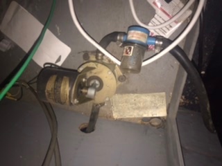

Got pics today she is flushing very slow. I had to turn water of to empty it. Let’s see if my pics upload

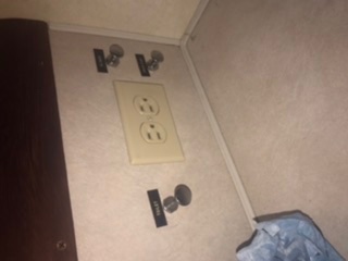

- This is “drain pump”
- B726EC55-2156-42D4-9AC7-77458850E1A2.jpeg (23.09 KiB) Viewed 4390 times
- Switches
- CD2AEF60-999A-4E70-B22E-0F61AF088898.jpeg (16.7 KiB) Viewed 4390 times

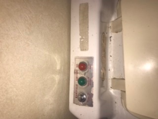

- Toilet I believe nothing is hooked up lights and button do nothing

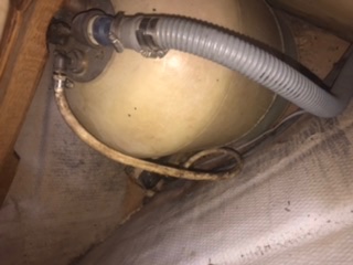

- Line off front pump I put my thumb over it and barely sucking

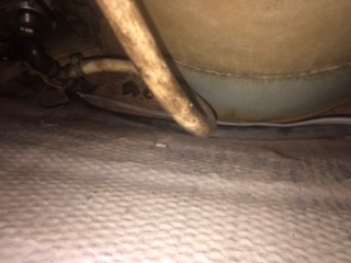

- Holding tank looks like a pool tank

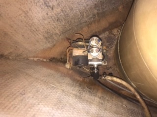

- Front pump that was rewired

Re: Hey guys new to forum but in year 6 of 76 f32 resomod
I did play some today and drain pump by fridge does drain the shower drain. No idea why it’s set to pull all from the rough the hull in motor hatch. I thing maybe just front pump is tired even though she works and sounds strong
