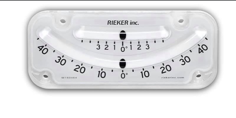

You can check degrees with a Inclinometer
