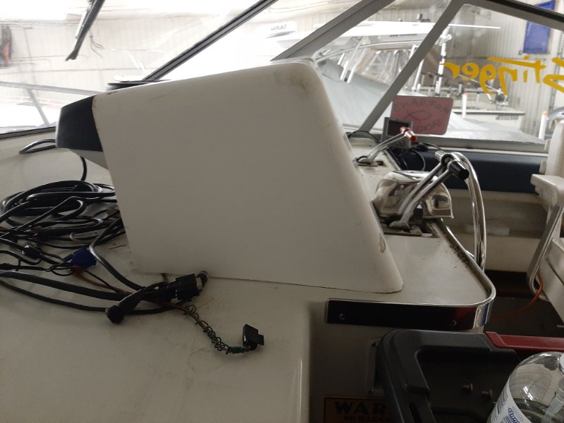

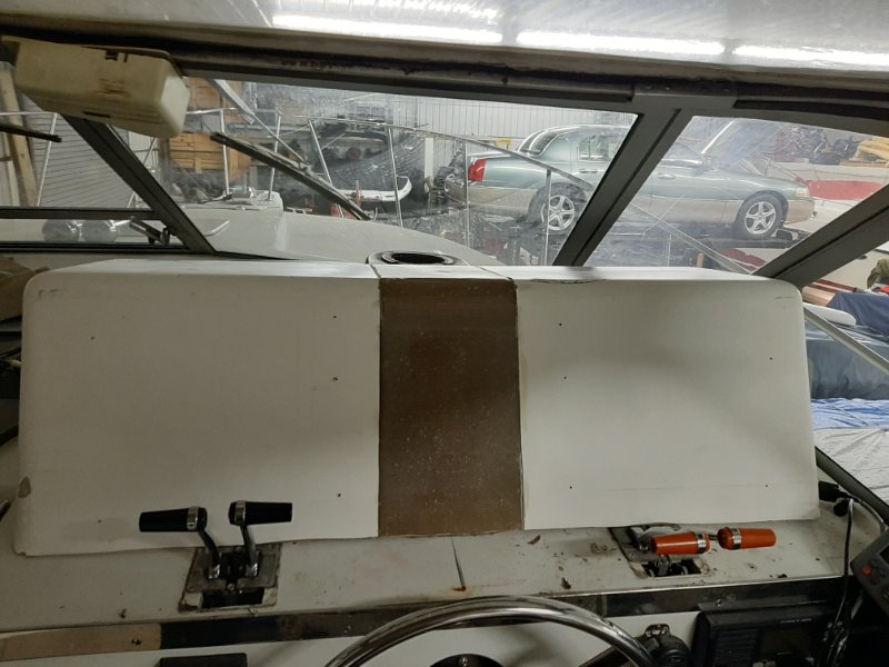

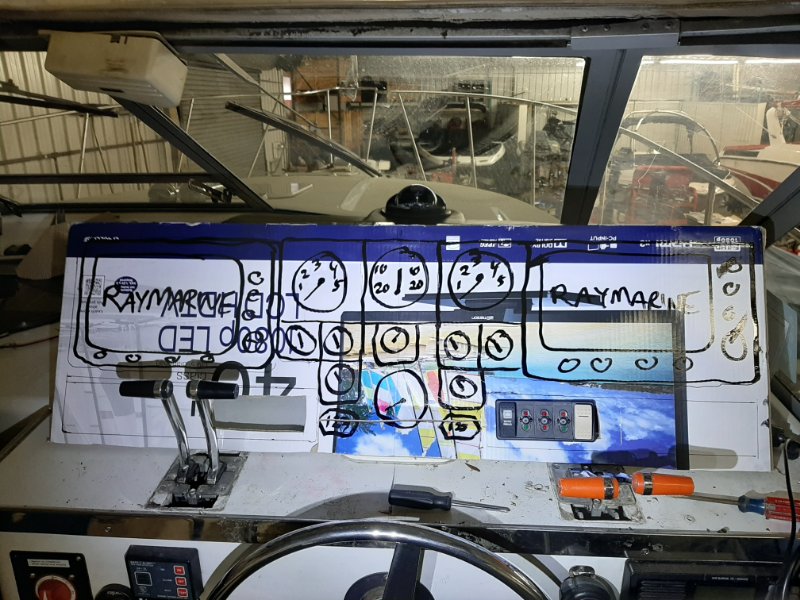

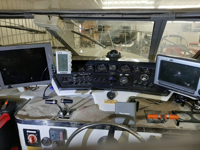

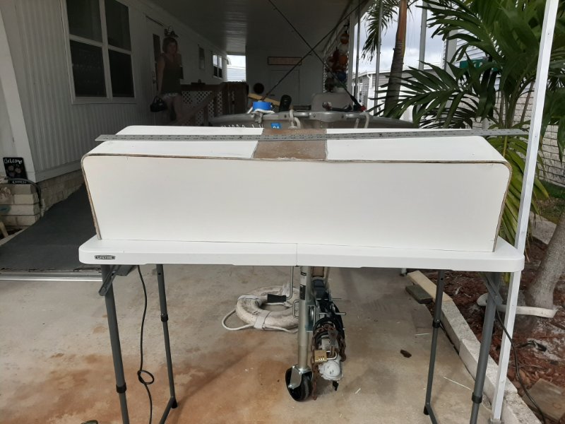

My 10 meter has gone thru many updates, but the one thing that still sticks out is the Star Trek dash. Although functional for its time, it hinders modern electronic layouts. I have started my long anticipated upgrade. I had considered utilizing the original dash but it just won't. work out. The plan is to remove it and replace with a new console that includes Vdo gauges, blue backlit Carling rocker switches, a floscan gauge, and room for 2 flush mounted MFD displays up to 12" each. this will really clean up the dash area and modernize it. I am going to be at my place in Florida for a bit so this will keep me out of trouble.
I will document this process . Here are some pics of before and with my cardboard mockup. The mockup will be pushed further forward once the original dash is removed. Also, if anyone needs a current dash, I will have it available once removed. Let me know
- current dash
- 20201211_112834.jpg (180.26 KiB) Viewed 13431 times
- side view
- 20201211_123848.jpg (157.08 KiB) Viewed 13431 times
- cardboard mockup
- 20201211_123748.jpg (193.73 KiB) Viewed 13431 times

Interesting , should be a good layout . Only issue I see is clearance of the shifter .

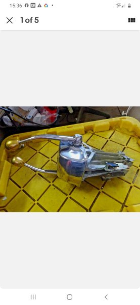

As it is sitting right now the shifter clears, My plan is to move that console forward about 3 more inches once the old one is Removed. I am also planning on removing the controls and replacing with the controls in this pic.

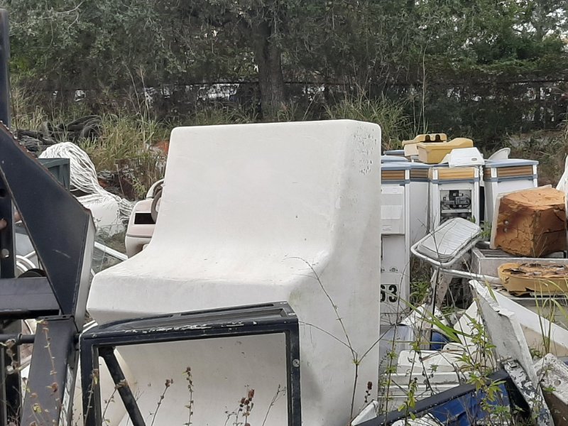

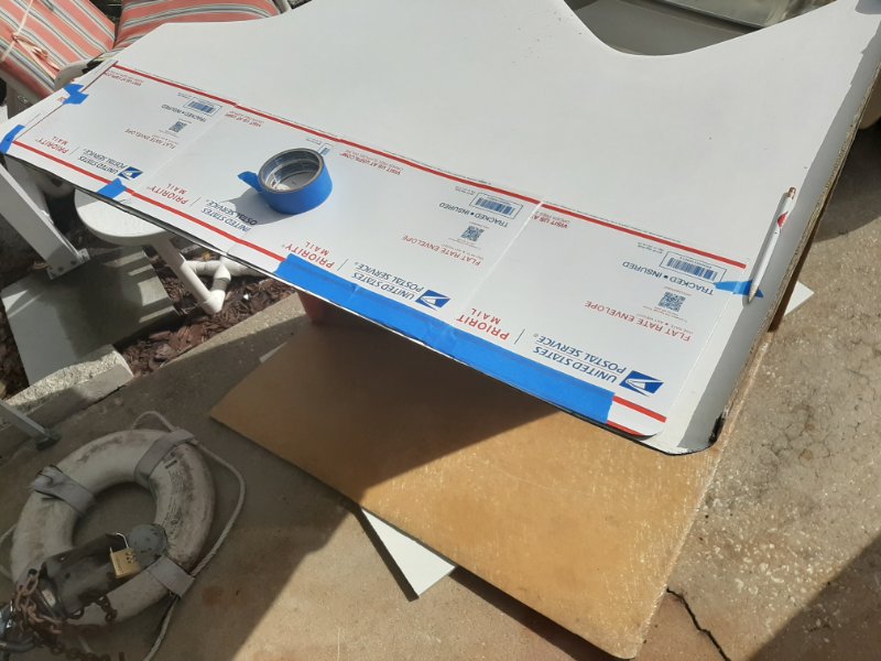

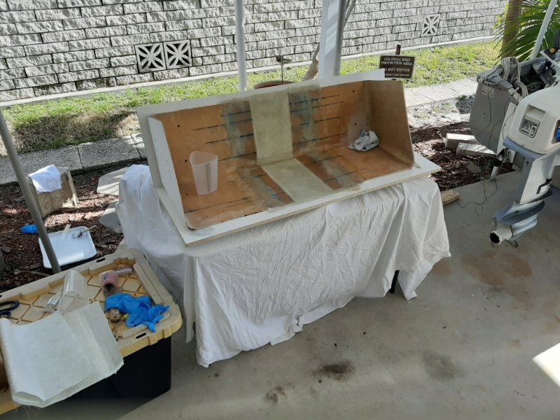

Well, I stumbled upon this donor console at the salvage yard and got a great deal on it. This will save a lot of work vs starting from scratch. My plan is to cut the top portion off to use for the dash. It is not wide enough, so I will stretch it by glassing in an 8 inch mid section. As you can see, I have it ready to cut based off of my mock up. I will harvest a flat piece off the side of the donor console to make a back panel. Down the road I am planning on cutting out the mid section of the donor console to use as an overhead electronics console.

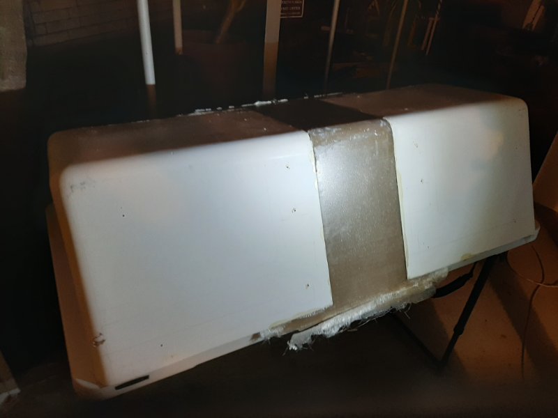

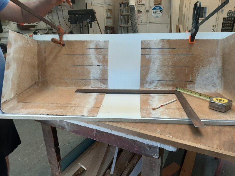

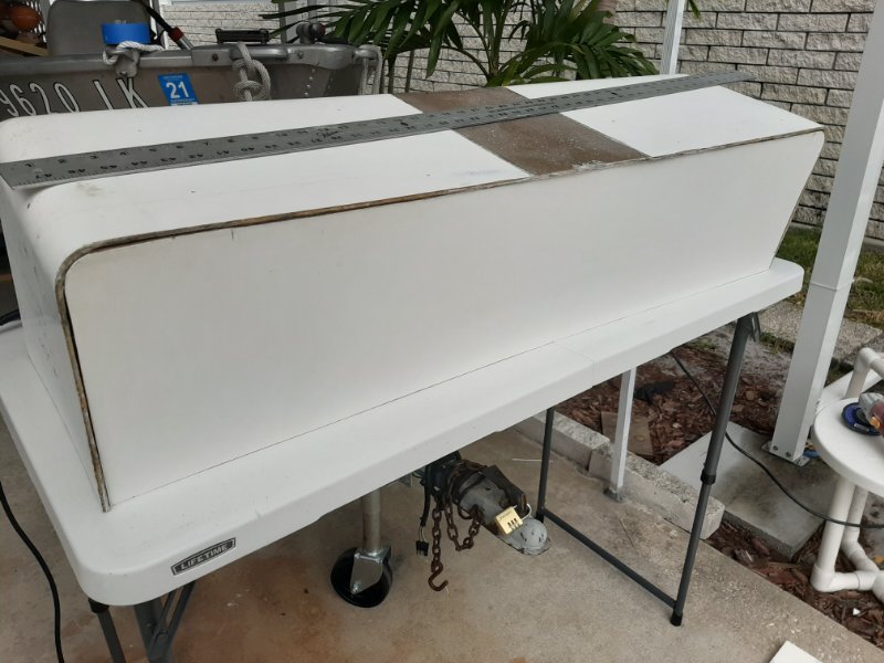

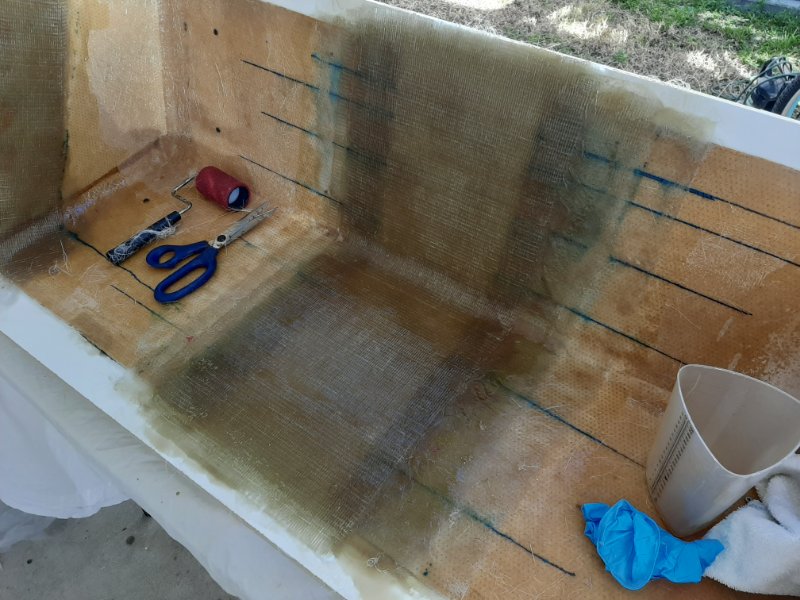

Here are pics of the donor console, cutting it, making the mold to widen it, layup , and removal from mold
- 20201230_182331.jpg (87.5 KiB) Viewed 13235 times
- 20201229_113241.jpg (194.14 KiB) Viewed 13235 times
- 20201228_143519.jpg (173.81 KiB) Viewed 13235 times
- 20201228_135016.jpg (152.62 KiB) Viewed 13235 times
- 20201202_153726.jpg (193.56 KiB) Viewed 13235 times

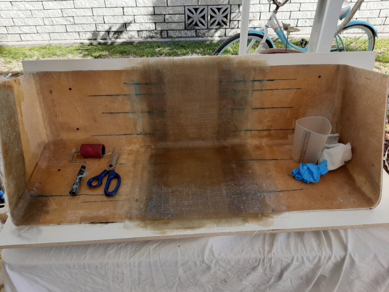

More layup photos
- 20201229_130327.jpg (165.69 KiB) Viewed 13235 times
- 20201229_130321.jpg (163.75 KiB) Viewed 13235 times

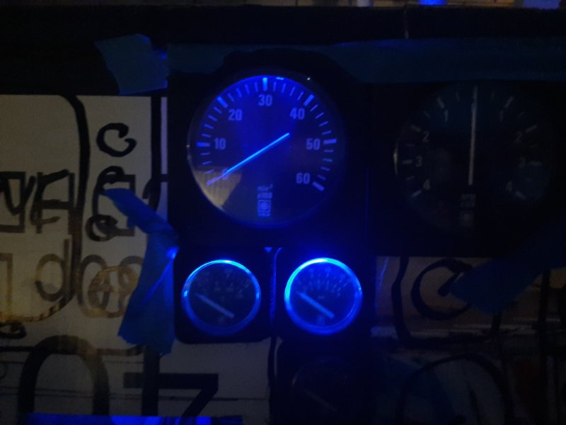

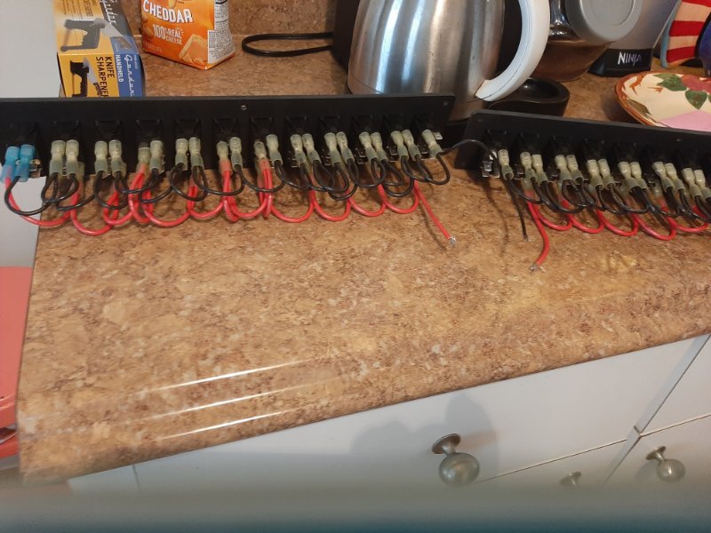

Re: 10 meter Express New Dash/Console Project

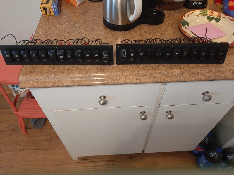

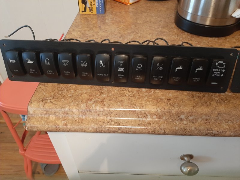

Vdo gauges after disassembly and drilling out red lenses and replacement with blue leds and blue led rocker switch panel including neat ignition start run switch. I am doing all of the wiring making custom harnesses as you can see. Heat shrink connectors, auto wire strippers, and ratcheting crimp tool are your best friend for this
- 20210102_144825.jpg (163.72 KiB) Viewed 13235 times
- 20210102_144802.jpg (136.7 KiB) Viewed 13235 times
- 20210102_144810.jpg (140.62 KiB) Viewed 13235 times
- 20201225_185950.jpg (92.15 KiB) Viewed 13235 times

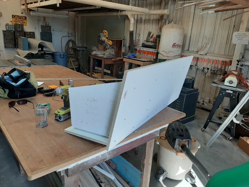

Back panel template , cut, and test fit

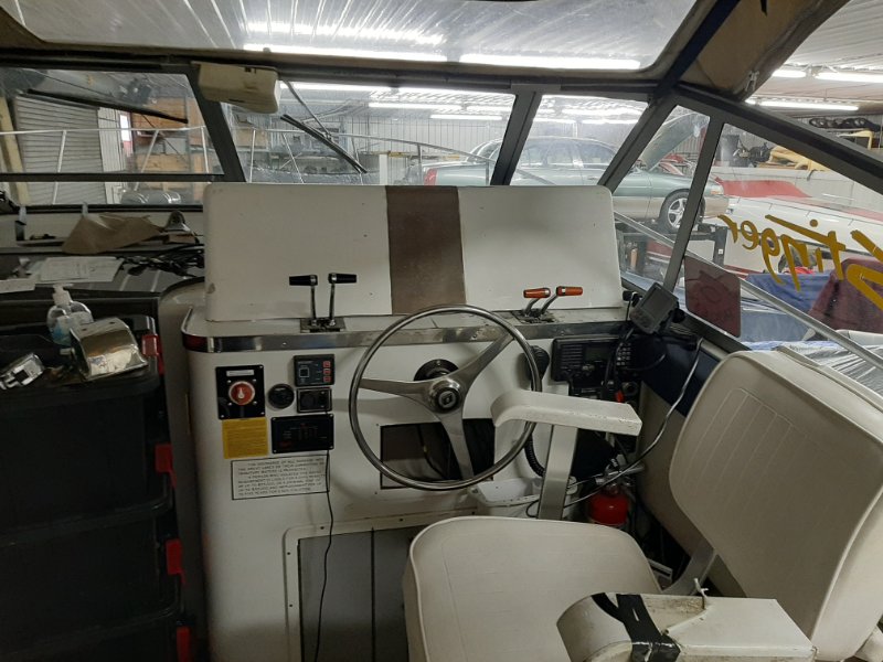

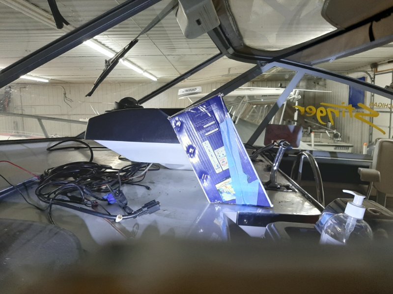

Test fit in boat. It will get pushed forward after I remove the old console. Ergonomically it provides the same view and is easily accessed from the helm chair
- 20210106_153332.jpg (157.28 KiB) Viewed 13235 times
- 20210106_153341.jpg (155.34 KiB) Viewed 13235 times
- 20210106_152003.jpg (125.75 KiB) Viewed 13235 times
