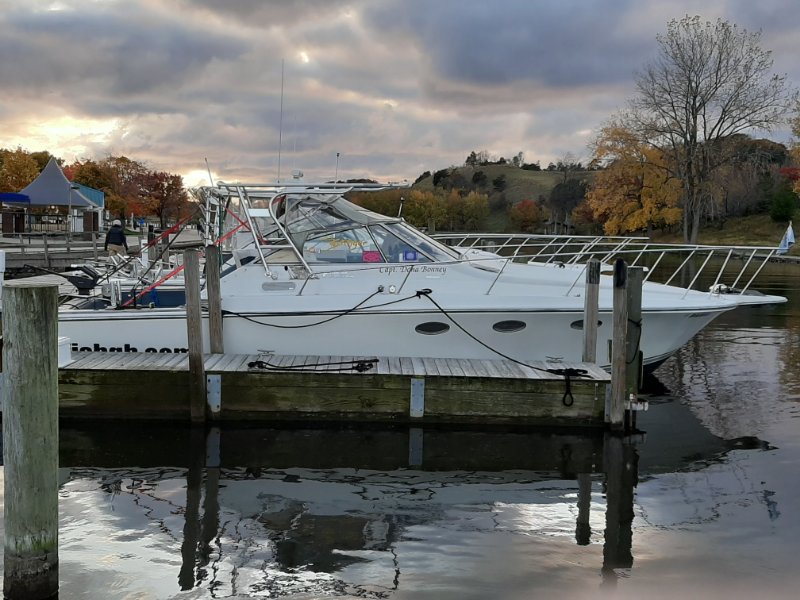

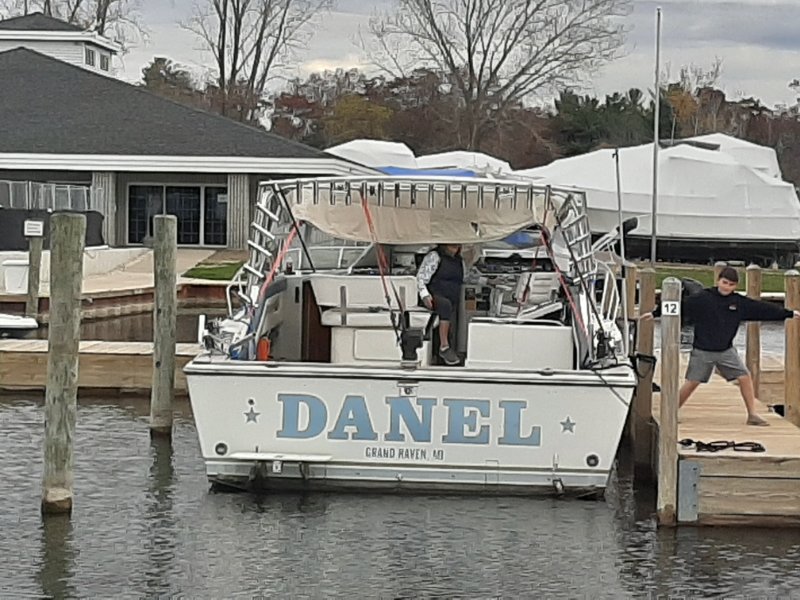

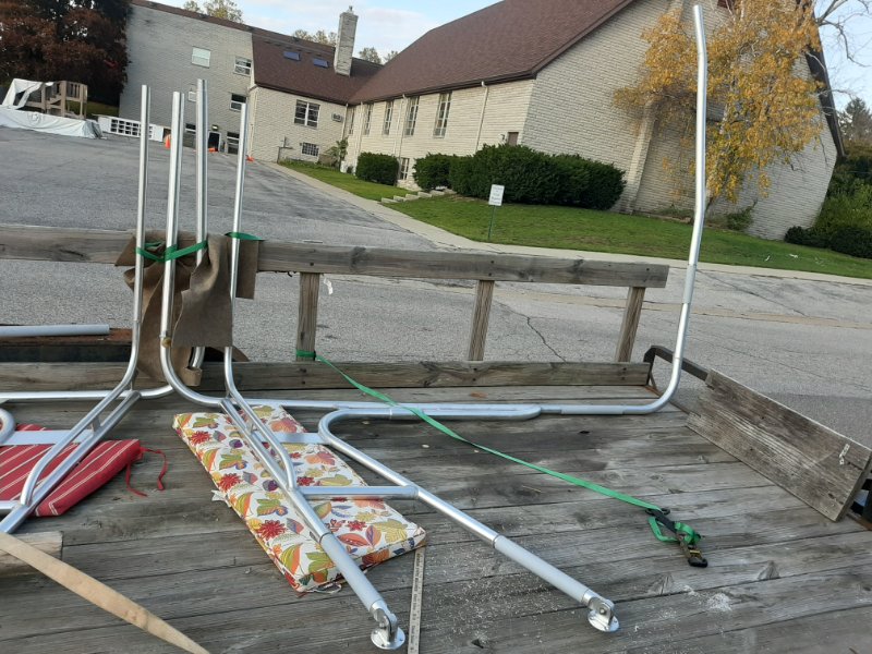

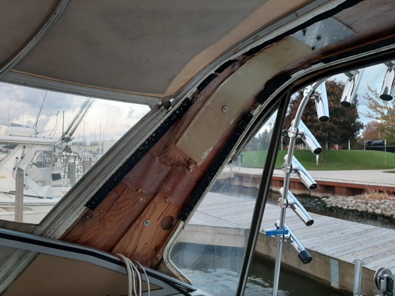

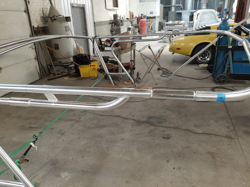

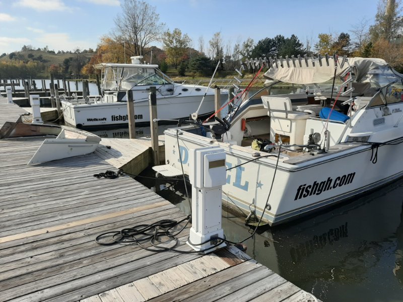

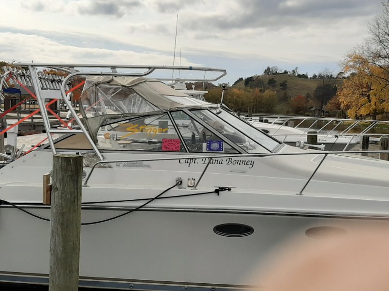

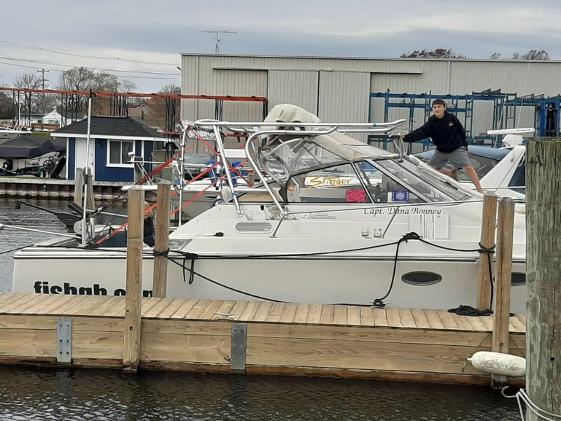

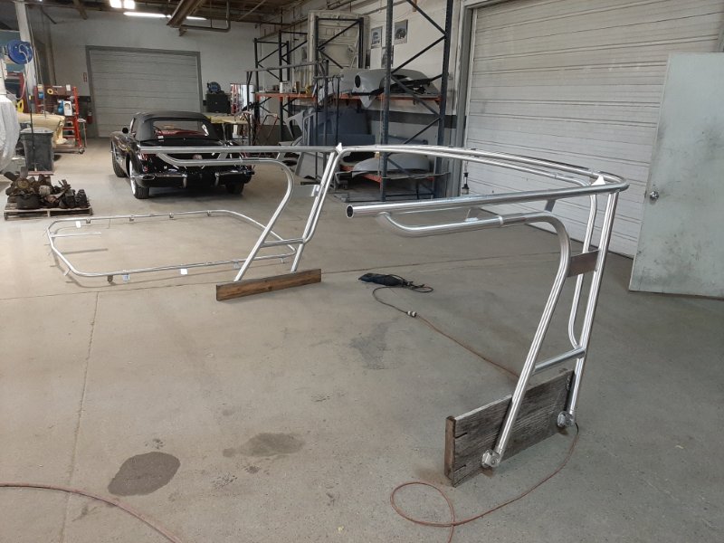

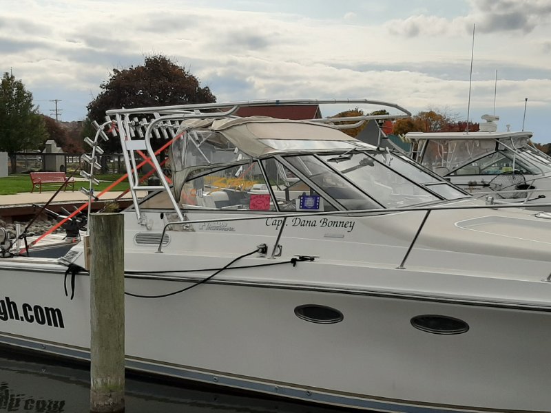

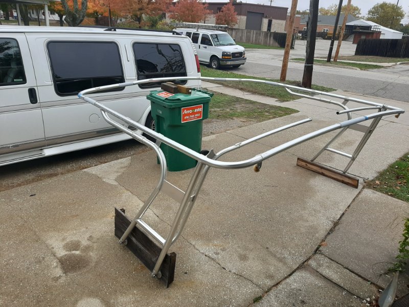

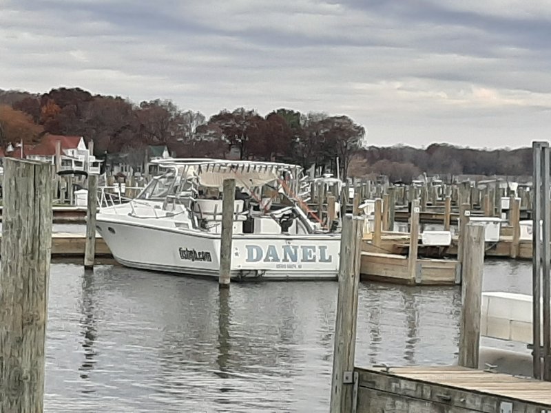

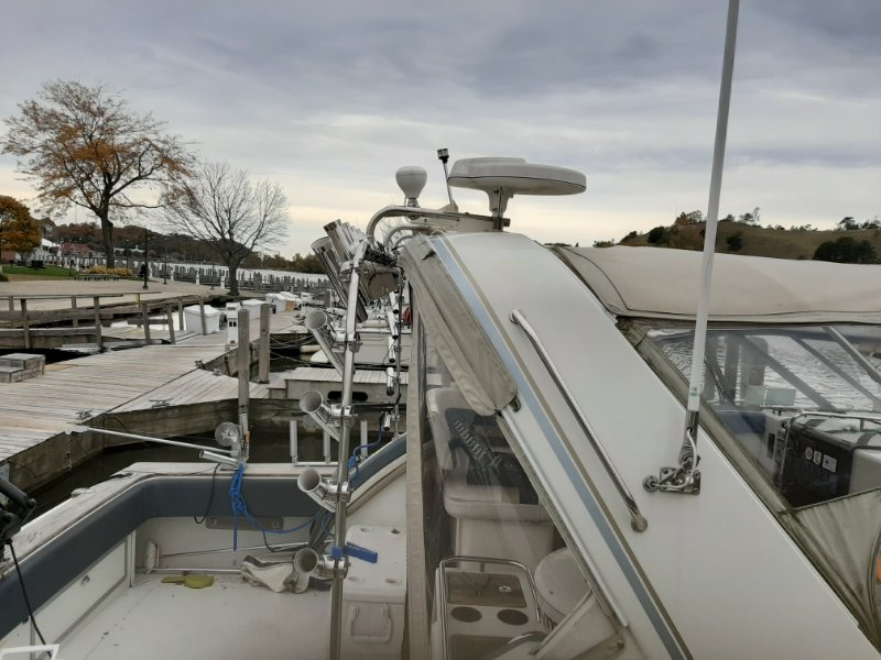

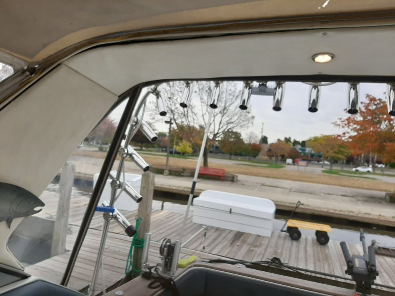

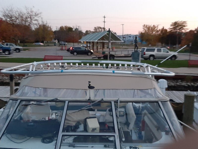

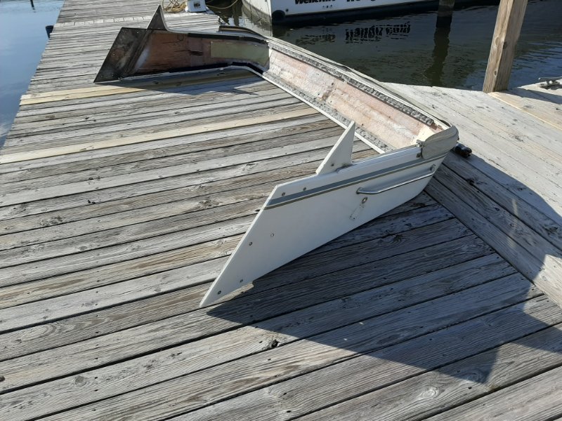

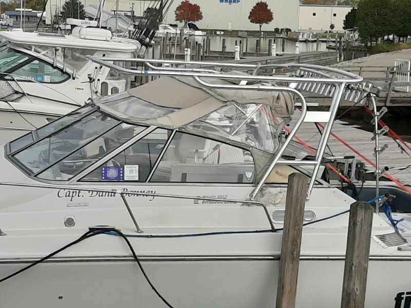

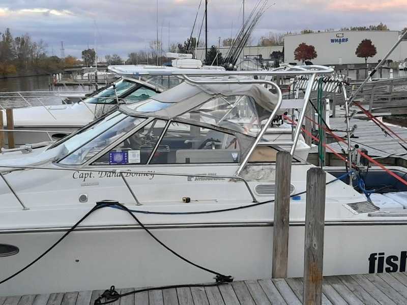

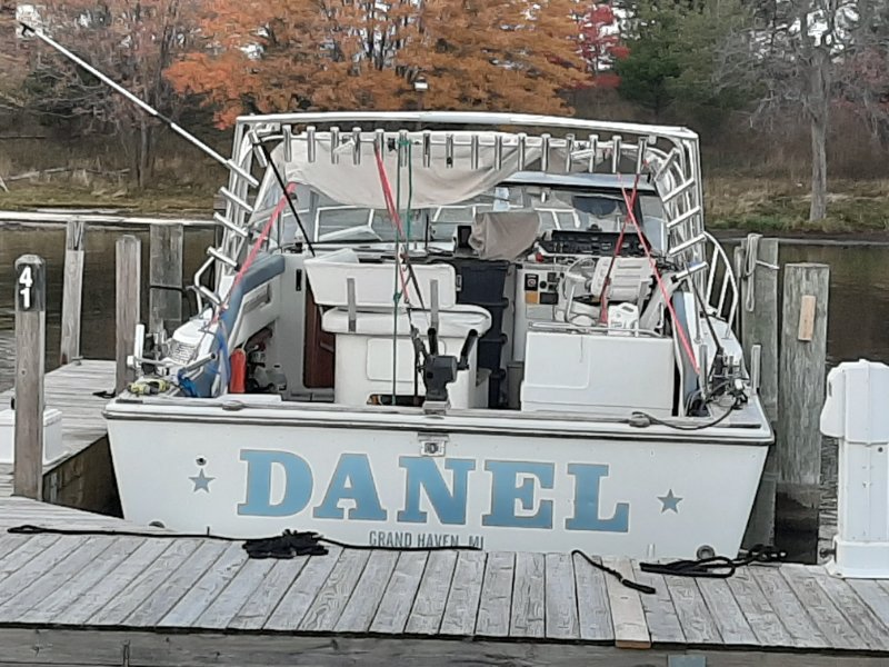

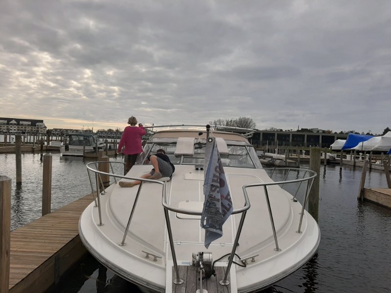

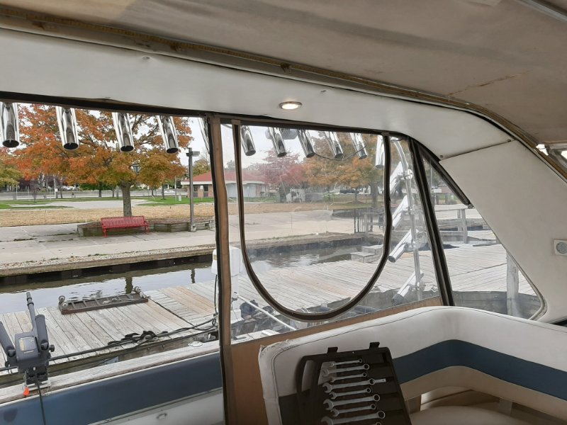

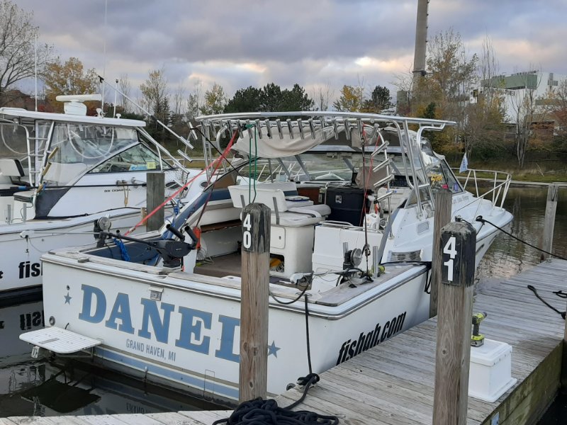

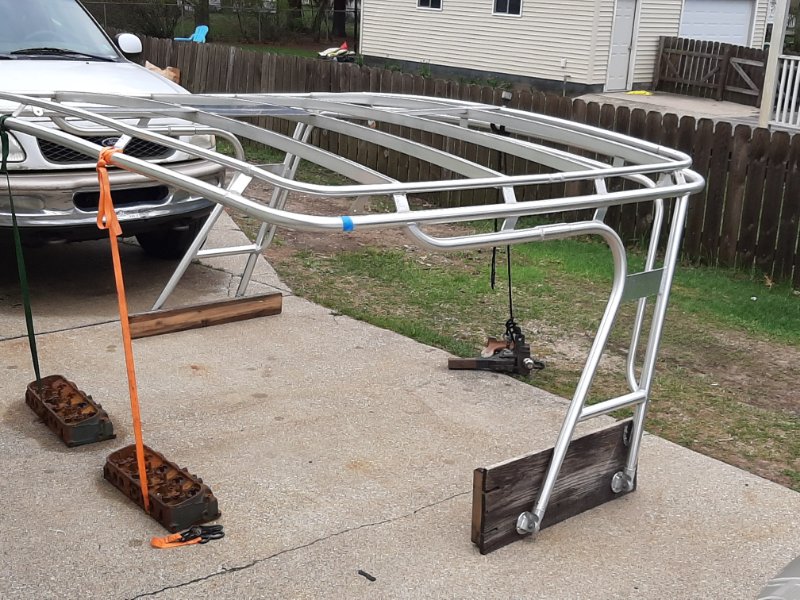

Well, I am am starting a long anticipated project. Removing my bimini and radar arch and replacing with a hardtop. I was able to get a used Atlantic Tower softtop frame that I am in the process of lengthening and widening. This will be followed with building a jig and making a foam cored fiberglass hardtop with twin bowmar hatches, more like a current production boat. I will keep updating progress. If anyone is interested, I will be removing the radar arch this week. and putting it up for sale. It had been previously repaired/strengthened in the corners.. Pictures are out of order...it is currently cut apart, getting ready to add sections and put back together this week

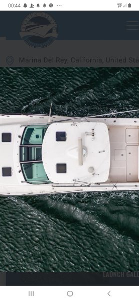

I am adding front supports as Atlantic does on their top. basically going to look like the top pictured. The overhead pic is from a boat with the fiberglass top and hatches...same as I want to put make and on the frame.

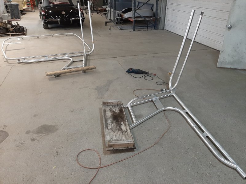

Well, I was able to get the radar arch off. Just 2 of us, my wife and I. She is a trooper! I did some mock up with PVC addied to the frame and did a test fit today...More revising coming on dimensions but getting close. I should have pics of it mocked up on the boat in the next day or 2. Pipe aligned Fittings came from Eastern Metal Supply.$5 each..very reasonable.. and tubing and foot pad is coming from Atlantic Towers.

Finally stopped raining and I was able to get a full mockup with dimension changes incorporating pvc in place of new tubing. Next step is to test fit this. Tubing arrives tomorrow...hopefully I can get it bent by the beginning of next week.

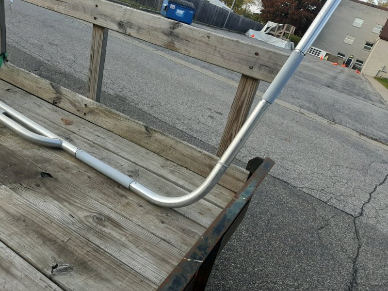

Test fit today. I am happy with the fit. It actually dwarfs the bimini. It is going to feel so much bigger. Tomorrow we will swap out pvc pieces with Aluminum pipe. I was able to get the pieces I needed bent yesterday. My wife was the right hand man...wearing carhartts...Taking her to Red Lobster tonight..

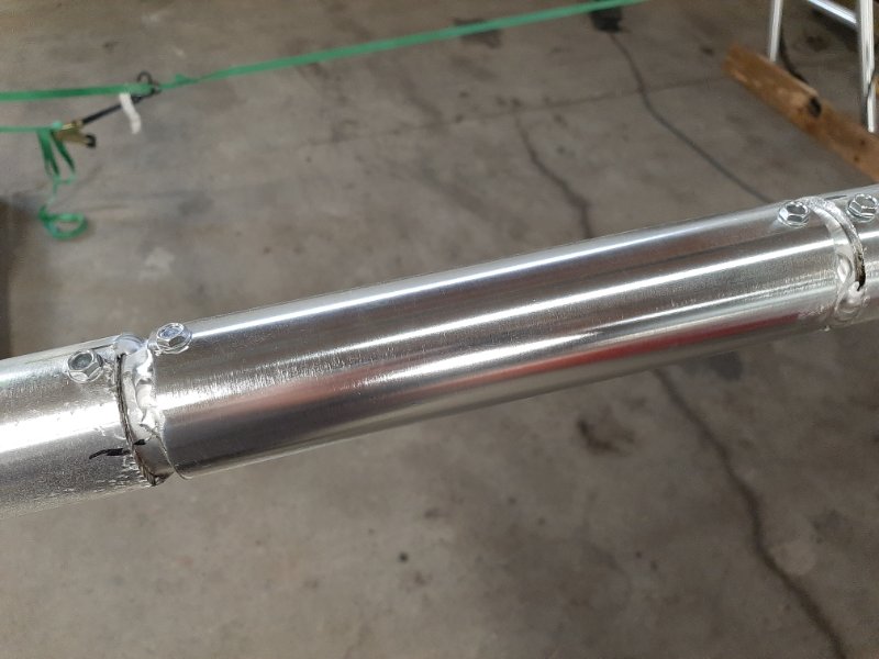

Today I shortened the front of the frame by 2 inches. My goal is to have the front eisenglass almost straight vertical instead of a forward angle brow.
I replaced the pvc with aluminum pipe and have everything in place with self tappers. Removed the frame and hopefully getting it tacked up tomorrow .
