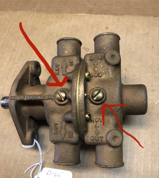

Hi all. New member and new owner of a Trojan F44 Motor Yacht. Boat has twin Chrysler 440 gas inboards. Can someone confirm which way the starboard engine raw water pump (Sherwood D55) goes on? Does it go opposite/flipped over from the orientation of the port side raw water pump? I took it off to rebuild it a couple weeks back. Life got in the way and well....yeah. I can't remember which way is right at this point. I think it goes with the cam mounting screws and the markings facing out, away from the engine block. I think that's what the markings for intake and outlet are trying to tell me ...but honestly they dont' make much sense to me. Just hoping someone knows for sure!

It should go just the opposite of the other engine . Check with Beacon on the hose . But if you have room for turns flex hose should work .

If the pump is spinning the opposed direction as the other , It has to be turned around to pump . Look at the markings .

Thanks for the help everyone. Much appreciated. It appears flipped opposite from the port engine for the starboard engine is correct for this raw water setup. (The side with the cam mounting screws and markings faces in toward the block on the port engine and out away from the engine on the starboard side.) Yes. I guess that's what the markings were trying to tell me all along.
At least I'm assuming that all is correct because it pumps water out the exhaust, I'm not blowing bubbles under the boat and nothing is overheating.
