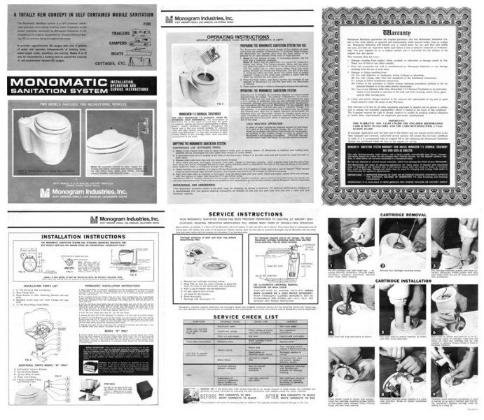

I do but it doesn't specify , I apparently have a monomatic toilet. I see a pumping handle in the closet. I am assuming that it goes to that toilet? Looking at youtube it doesn't really give me much of a clue. I don't see a water hookup for it, though that line runs into the pump. Does that pump fill the toilet? How and where does it evacuate?
Re: Air conditioner
I Had One of those . First boat project I did was get rid of it . recirculating toilet ? not on my boat
"The Monomatic is a self contained recirculating toilet. It has an internal maserator and circulating pump. It needs a "charge" of a gallon or two of water with a preservative chemical added. They work a lot like and airplane toilet."
- MonomaticToiletManualPagesAllMAIN.jpg (108.92 KiB) Viewed 7059 times
Re: Air conditioner
So I simply dump a couple gallons of water into the toilet? when i flush it then I have to add water to it as well?
