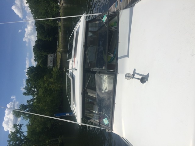

It’ been over 20 years since I bought our F26 HT and I’ve always thought the hardtop would be a perfect place for solar panels. Problem was other priorities (job, kids, etc etc) and cost of solar. Things change (retirement, kids off and married, etc, etc) and solar costs have come way down. During the quarantine period here in upstate New York I spent a lot of time pricing out, googling, and you-tubing solar equipment and panel sizing for the hardtop. Last month I pulled the trigger and bought 2 170 watt panels with max amps at >9 a, a Victron solar controller and assorted solar wire, fuses, terminals, etc.. Total cost was $745. Today I finished all wire routing for panels, controller, fuse, etc as well as hooking the Victron (100 v/30 a) controller to my house bank of 2 110 ah flooded cell batteries. Next week I’ll mount the 2 panels in parallel to give me max 18-19 amps of power to my house bank if the sun is shining......I’m taking pictures as I go forward and will be happy to share these and any questions you may have. We like to get off the dock and unplug for stretches of 2-3 days out on our lake. The plan is to have old man sun keep the house bank loaded during the day so we can keep the beer cold in the fridge! I went with the higher priced Victron because of the Bluetooth enabled app that shows charger and battery information in real time as well as history.....and besides I think it’s cool!

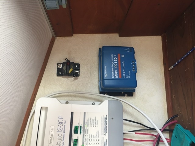

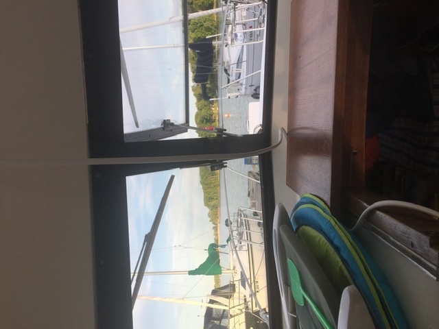

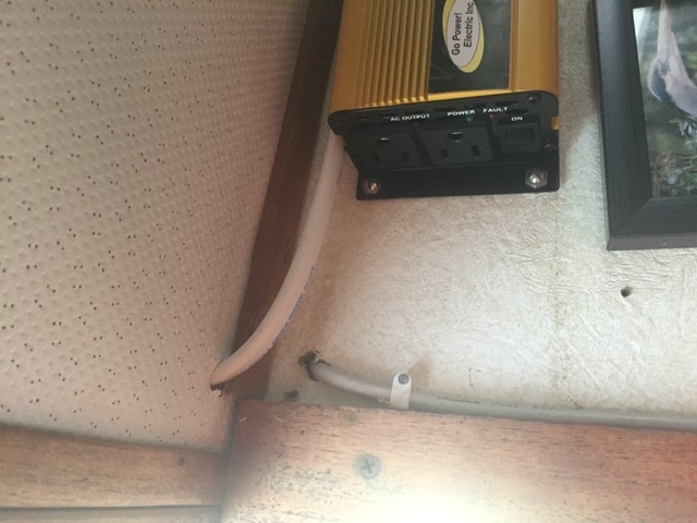

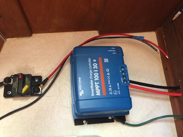

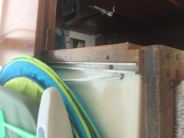

Just sent a reply to drudodson with info. I’ll try to send pics now.

Thanks for email and the pics, great info! Looks like a clean and neat install. Interested to hear how it handles the frig load. Manual or electric head? Going to do LEDs on interior lights? Very cool.

I left the boat two days ago, after the install, with power only from the solar panels. Shore power turned off. Today I went back to redo some grounding wires and take a look at what was what. Victron Connect is a Bluetooth enabled app that can be used via iPhone or android, and shows you solar and battery conditions as well as all sorts of charts, info, etc. The charger was in “float” mode, showing a trickle charge of 13.4 V and no amps going into the batteries (I have 2 110 ah deep cycles wired in parallel for a house bank, and the solar charger is only hooked up to this bank. The starting battery is on a Blue Seas ACR and isolated. I turned on the whole shooting match in the boat: Norcold AC/DC fridge (original and till working fine), stereo, cabin lites (all are LEDs), nav lites (also all LEDs) VHF radio, water pump, and spotlight. I then watched as the Victron Connect app on my iPhone showed me the solar panels going from 0 to 320 watt with 21 volts and the charger pumping in 14.7 volts and 10 amps with room to pull another 7-8 amps from the panels into the house bank. So, that’s me maxing out all DC loads from the house bank. Using a 50% capacity for the house bank that gives me 110 amp hours before the batteries are going to be screwed. At the full 10 amp draw that lets me have about 11 hours before that happens. But, the fridge is one of the biggest draws on the system at 3.8 amp, and it does not run constantly, more like 30 minutes each hour when it’s hot in the cabin. The LEDs are minimal users of amps, and I never have them all on at the same time. When off the dock and on the hook the anchor light (LED) is one and drawing <1 amp. All in all, I think my system will keep up with demand without need for shore power - so long as the sun shines, but the panels should have enough power even in cloudy conditions. Time will tell. By then way, I’ve been using Walmart Everstart MAXX 29 batteries in the boat since I bought it in 1999. These are about $100 each and I replace them every 4-5 years, periodically checking the water level in them. A lot of our boat time is off the dock, as we like to anchor out or glom off a restaurant dock when available (none have power), and we’ve taken the boat on a 2 month cruise on the Erie Canal so it’s set up for comfortable cruising on protected waters, and that’s the way we like it!
