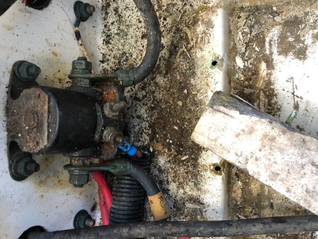

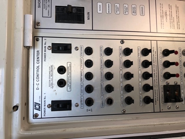

Some photos
- Paralleling solenoid
- 6147D690-3C54-4187-90FE-9F239BBFA633.jpeg (146.21 KiB) Viewed 2990 times
- Switch board
- 57F5C915-04BF-48D8-98D9-3E6CEF5E32DE.jpeg (102.25 KiB) Viewed 2990 times

not sure if I can help here or not but here goes
try and turn the port engine manually that will tell you if it is frozen or not
check for loose wires I recently replaced a starter motor needlessly only to find a loose wire on the nuetral safety switch (the switch turned out to be bad as well)
electrical things may behave differently under load
I have three batteries, one for the house only
my ignition alarm only sounds when switched on at the helm
hope some of that helps
