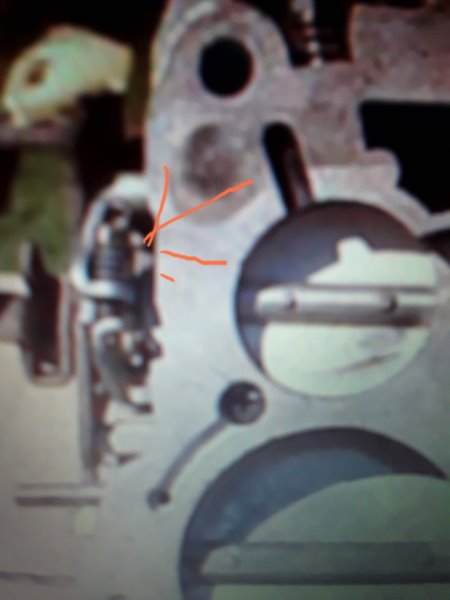

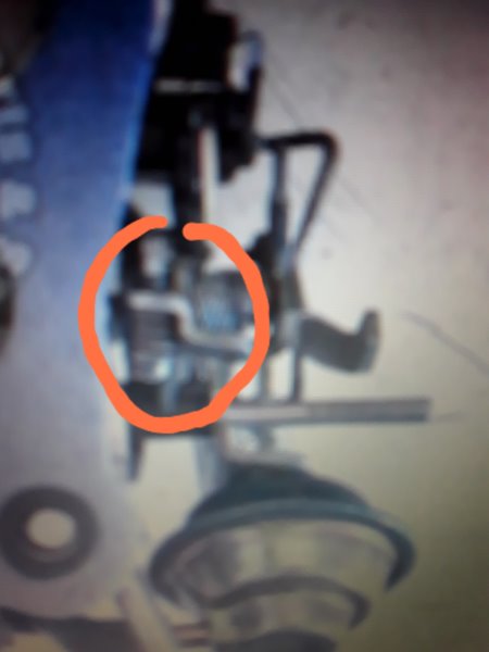

So on mine it looks like the front piece once held a screw but it doesnt now. Whats funny is the other carb is the same but fat idles perfect at 10k
Hope this shows what im seeing. That large flathead screw doesnt seem to do anything except hold those parts on.

Re: Engine issues

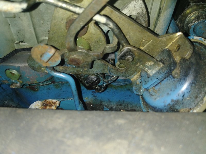

Forgive the poor photos of photos . The screws viewed from the bottom of carb . I have always hated chokes on a boat , I used to set my lean or open by disconnecting .But you have to play with the throttles till they warm up a bit Nice thing about diesels no choke . Did I tell how much I hate chokes on a boat ?
I am not 100% all did have the screw ,but thinking they did and always had trouble seeing it . And that was in the old days when I had good eyes .
- q-jet 2.jpg (29.7 KiB) Viewed 15241 times
- q-jet1.jpg (26.48 KiB) Viewed 15241 times

I see what your referencing. Mine does not have that screw. It does have threads for one though.
