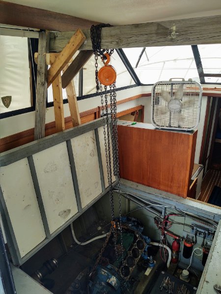

Built an A Frame to pull the motors. Then some bulkhead and stringer repairs and a fresh coat of Bilge paint. More pics to come.

Did you run into any issues lifting them out with the A-frame? Any notes on position or additional support underneath?

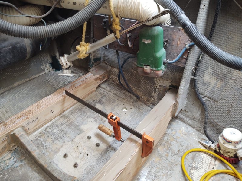

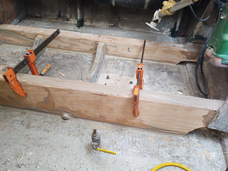

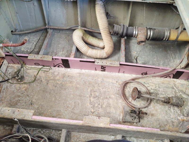

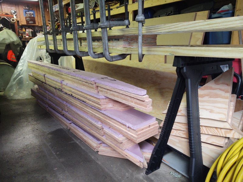

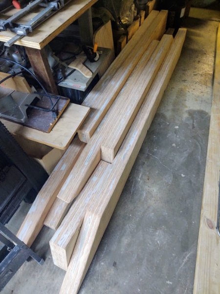

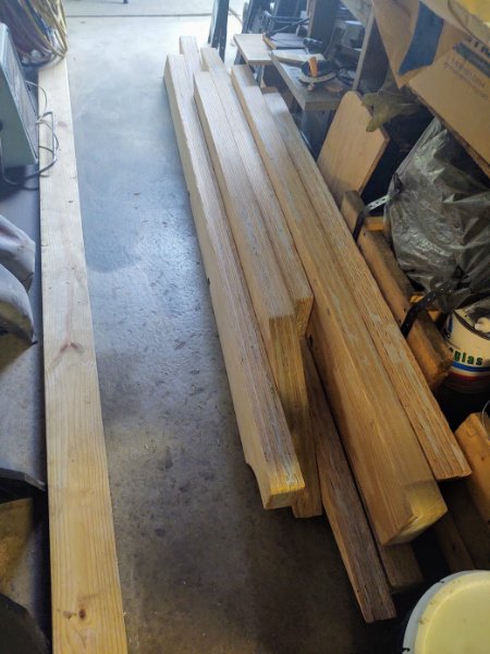

Well during the summer I made new stringers.

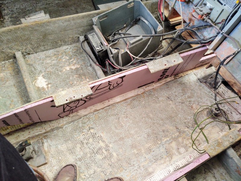

Created templates out of foam insulation board and then transferred them to 3/4 inch Marine ply.

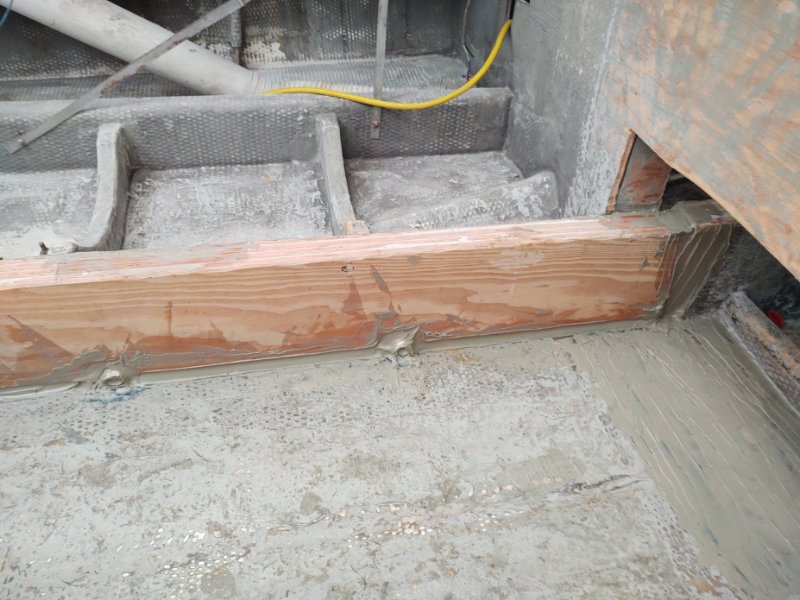

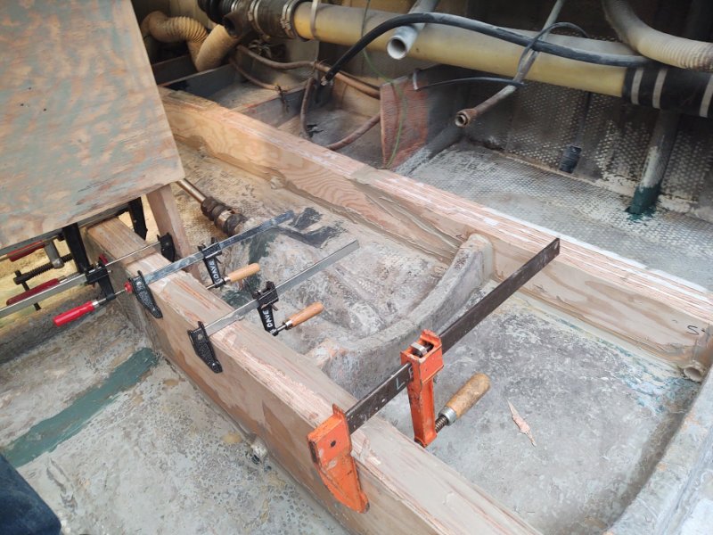

I bonded 4 layers of ply to create 3 inch wide stringers. Bonded the stringers in the hull and then will encapsulate them in fiberglass.

More pics of the bonded stringers

buffalobill wrote: Thu Aug 13, 2020 9:39 am Wow, that looks bad. Could you post pics during replacement? Would you consider steel fabrication along with the new wood? What bilge paint do you use? Thanks.
I wouldn't use steel as a replacement. I think it would be to heavy.

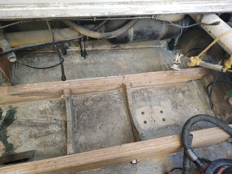

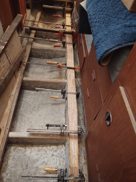

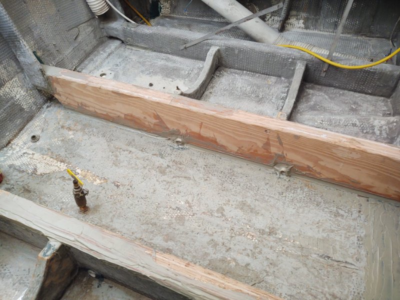

Bonded another stringer down last night ! One more piece to go tonight then the encapsulation starts.
