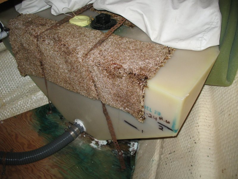

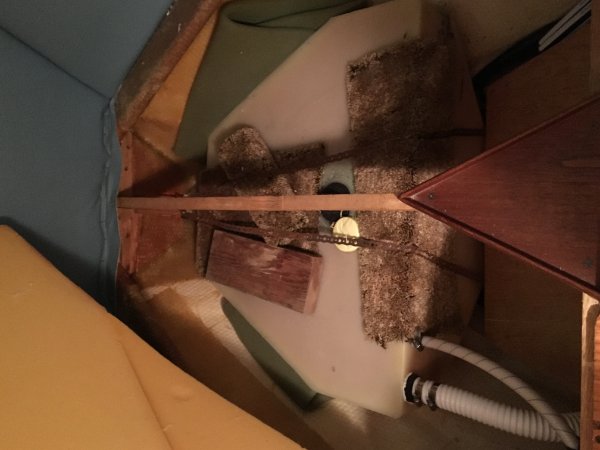

Not sure what size it is, but at some point in my boat's life someone added a holding tank under the v-berth. Head was the original Monomatic recirculating unit, but they plumbed a waste hose out the back of it to feed the holding tank. The head has a 'discharge' fitting.
Tank is a funky shape, designed to fit the hull.
Holding Tank 1.jpg (107.49 KiB) Viewed 4013 times

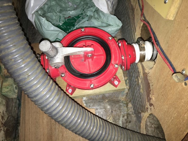

The hose out the back of the head goes to a manual pump in the port hanging locker, then from there to the holding tank.
We would use the head in normal recirc mode until full, then use the manual pump to empty it into holding tank. Then we could recharge the head with fresh water and chemical and be back in business. We could do 3 transfers to the holding tank, so the recirc head could actually be filled 4 times, before we needed to get a pumpout. And when pumpout happened it would empty the holding tank and also pull everything in the head through the lines and suck it out too.
