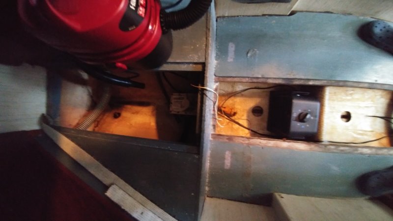

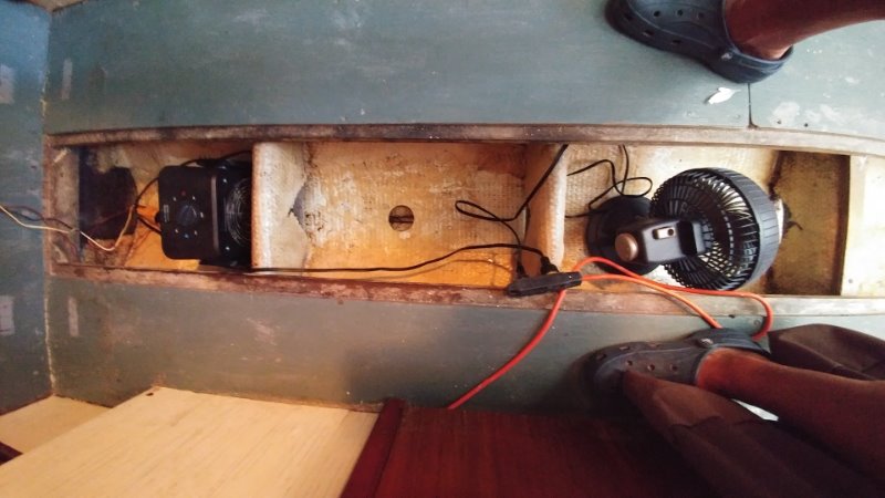

Re: F32 Hollow Keel
I also have this problem with my F-32, it was brought to my attention by the mechanic at my marina last fall when he took my boat out of the water.. I have noticed a dirty water smell for awhile and was using the wet vac to get it completely dry but smell remained.. if someone could post pics of where the drilled, what size drill, what kind of pump they used that would be great

Re: F32 Hollow Keel
Sorry, not at my boat at present. I have 3 holes about 3"s each starting about even with the steps, forward to the singer at the birth. Distance about 6 tp 7 feet.

Re: F32 Hollow Keel
I am going to drill at the end of this season, does anyone have pics of the location they drilled? need smell gone

Re: F32 Hollow Keel
thanks for the pictures, boat coming out next week... gonna get water out before winterizing

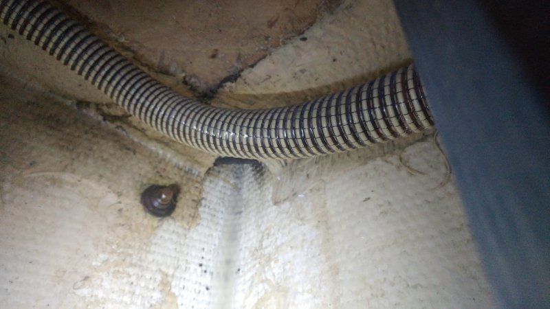

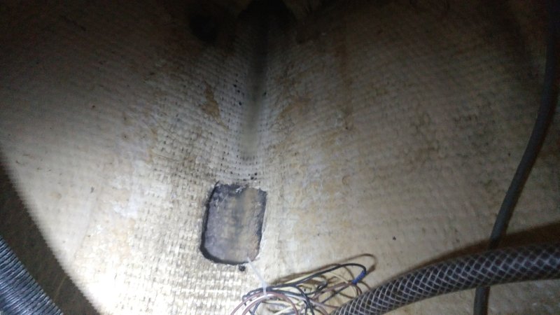

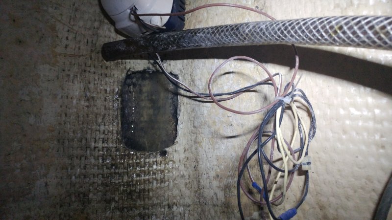

Re: F32 Hollow Keel
Actually created a new hole up front and lowered a bilge pump there.
- 20200811_170433.jpg (81.25 KiB) Viewed 18792 times
- 20200811_170448.jpg (81.36 KiB) Viewed 18793 times
- 20200811_161438.jpg (112.08 KiB) Viewed 18796 times
F32 Fly 1975

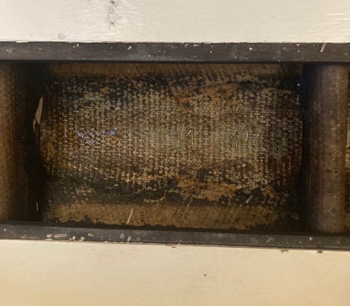

Re: F32 Hollow Keel
Am I correct that the “hollow keel” is under this glass matting?
And yes I know it’s filthy—My apologies!
If so, how deep is the keel/void?
Thanks!
Thanks!
