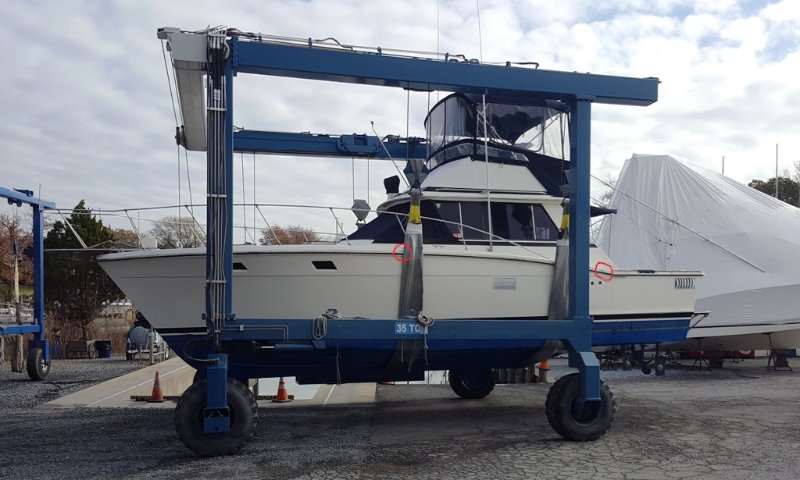

Here is a picture of our boat on a travel lift with the factory specified locations circled in red. The travel lift operator was not comfortable with the specified rear location and I couldn't get him to use it.
Sling Locations.jpg (75.44 KiB) Viewed 6627 times

Hi guys, thanks for the mail. The picture of your boat in the travel lift is perfect! Pretty much what I'd have guessed, but always nice to get it straight. I appreciate it. Have a good nite, Dave
