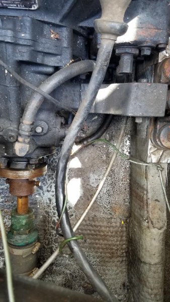

This is best I have now will post a better pic if needed? Thanks for info
Re: 215 MerCruiser Drive / transmission
BW Velvet drive
