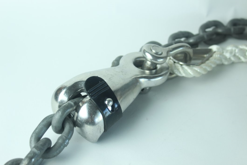

We use one of these Mantus chain hooks, and it is awesome.

I guess I should have clarified, that the chain hook is cleated off, then I back a bit of tension off the windlass, so that the hook and line are holding the weight of the anchor. The windlass should never be used or trusted to hold the tension of an anchor underway or at anchor. We carry 100 feet of chain and 200 feet of rope, so when we are anchored we either use a snubber, the chain hook to the cleat, or if into the rope, the anchor rope to the cleat.
