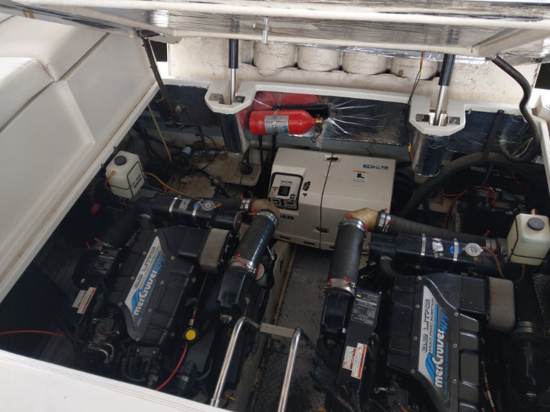

@Prowlersfish and others - Here's some additional information regarding the batteries / charger situation.

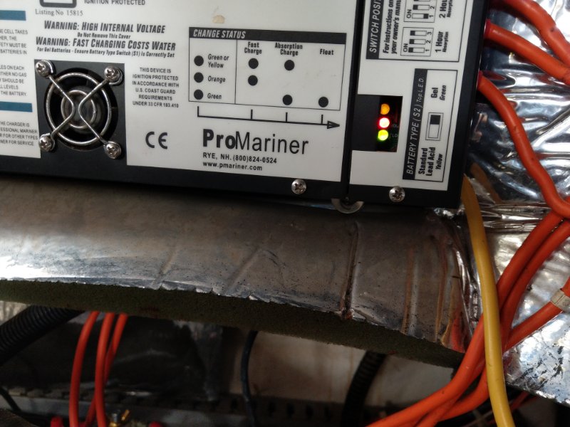

I too have the original ProMariner charger. After purchase, I replaced all 4 batteries with AGM. 2- Bank 27 (Gen and Emergency) and 2 Bank 31 (Starter / House). Previous owners had all 4 undersized with Bank 24's. This I learned put a lot of stress on the engine starters - I kept wondering why the salesman and others would parallel every time they started the engines - not right! Replaced the starters and they kick it over like nothing!
Like Rickalan35, I just don't get why the Gen is hooked to the charger but I guess I can remedy that situation.
You can see from the pics below that there's an error on the charger - not all the time, but just so happened to be in this pic.

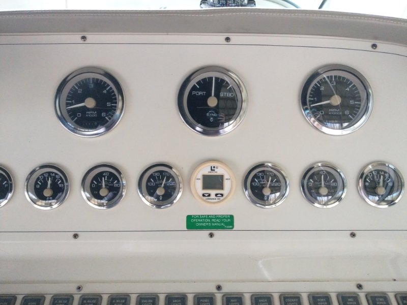

Seems the port side battery (#1) is the 'horse' and seems to have just about everything wired to it including bilge pumps, stereo and subwoofer, etc. Boyfriend and I have implemented a system to use battery #1 on odd days and #2 on even days to allow a somewhat equal level of discharge/recharge on the batteries. But, it seems that the #1 never catches up....even after running the engines for quite some time. It's like the charger says 'you've got a full charge on starboard side, I'm done'. Also, I just replaced the forward bilge as it seemed like it was struggling to move water (we'll check the discharge hose again for airlock and to make sure there's not a check valve or something) but it seems like it just can't get enough juice to move the water. Not critical - the boat is pretty dry - but when you need it you need it!
I do know that if #1 battery gets even the slightest bit low, the stereo shuts off or won't come on at all in the first place and can only assume the sub is drawing way too many amps. I may consider trying to isolate that to it's own breaker.
Also, the 3 wipers don't work at all. No power/lights on the control panel or helm station so not sure if that's a breaker, power or fuse situation.

Since you have gone to AGM batteries your charger needs to be set for them .

Well, that seems simple enough! Setting the charger right... Duh.

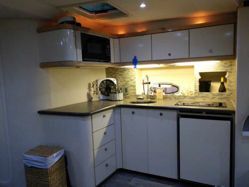

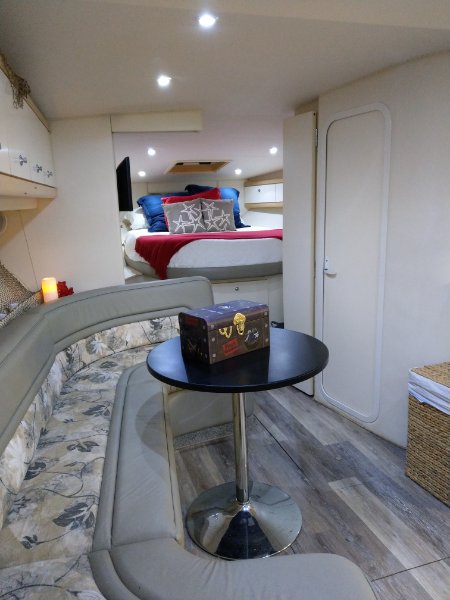

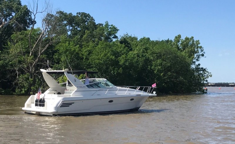

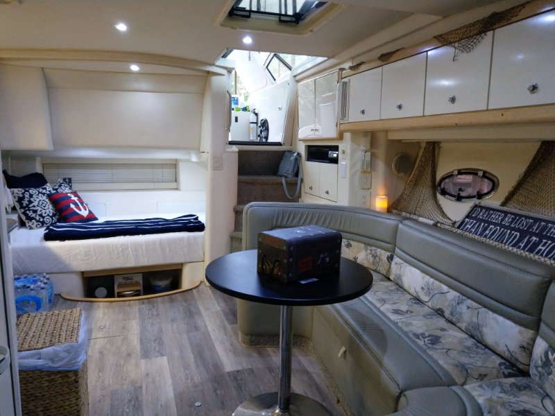

There are any number of very experienced Trojan owners on this Forum with heads literally stuffed full of both Trojan and Boating knowledge. They will be extremely helpful to you as any question or problem that pops up here seems to have someone who can usually answer/solve it.
Those are great photos. I've been a member here for thirteen years and still don't know how to post photos. At one point I did, but that photo service provider disappeared (forget their name)........ and here you are posting photos on your first day.
I too have those 502 Bluewaters in my '94. They were an expensive option and we're both fortunate to have inherited them in my view. Unlike your Kohler my boat came with a Westerbeke generator. Your Trojan looks pretty much looks like a low-hour boat to me because of the great shape of the upholstery and interior wall surfaces etc.

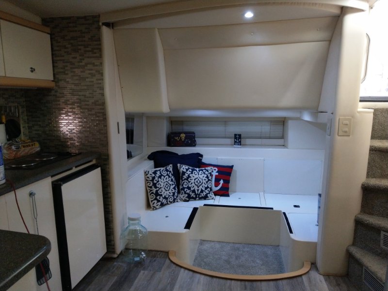

I notice that the replacement mattress in the midcabin appears to be sitting upon the stock Trojan "fold-up" sleeping platform (which has steel tabs at each end that fit on the fiberglass seat bases. That platform folds up and fits easily into the mirrored, starboard-side locker just above the midcabin seatee. There are also two special cushions that may still be with the boat (look in that aforementioned locker) which are designed to fit that sleeping platform. Then the actual seat cushions (the ones you list as currently missing) are designed to jig saw together to form the rest of the bed = In other words they will turn into "your usual uncomfortable sleeping experience."
I don't blame the previous owner for having brought in a replacement mattress, but unfortunately there is no place to store that mattress when not in use.
Does the privacy curtain that divides the mid-cabin from the rest of the boat still function properly?
Regarding the batteries. You will notice that the manual instructs you to cruise with the Battery Selector Switch on either Position 1 or Position 2. Never cruise with it on ALL. The reason for this will probably be better explained by Prowler Fish than me. But that may have something to do with your uneven charging while under way.
An added comment might be to "Be careful raising the hydraulic engine hatch past its detent position." If you do, you will be stuck pulling out the cockpit fridge and getting in behind it where the engine hatch controls are located. Ask me how I know this.

Well, just as you were likely writing this I did call the mechanic over... It's the charger. Totally no good. We tested it every which way from sideways... Nothing. Sooo, now on to find a new one and the challenge of wiring it correctly. Mechanic did suggest a 2 or 3 bank (generator optional) and wired directly to the batteries not run into the selector switch as it is now. So all in all I feel much better about it all.

Glad you found the issue . Nothing wrong with staying with Promariner . Of course there are other good choices out there like Mastervolt and others .

I am a little confused by your question about the heater. Did you perhaps mean "under the mid cabin seat"? In my boat, there is an eleven gallon Seaward electric water heater/heat exchanger. It's located under the mid cabin seat (the seat visible in your new photo). Engine coolant runs through it when we're underway thus heating the fresh water in the eleven gallon tank. When plugged in at the marina, the water heater uses AC power to heat the water in the tank.
I see in the photo that your galley wall has been updated with modern wall tiles by the previous owners. Looks very nice.
