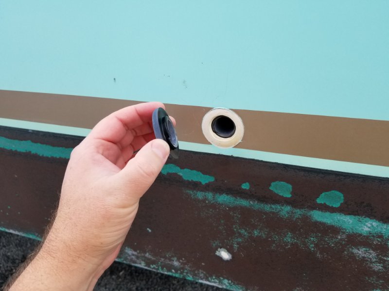

Re: Best way to find a leak??
Bronze below the waterline, stainless above.
Plastic sucks.
Don't be the guy in the picture. (just happened to touch it after we hauled out and it came off in my hand)
RWS wrote: Mon Jun 03, 2019 10:01 pm Watch out for MALERON plastic fittings at the water line.
After decades in the sun, they can easily break apart.
Bronze, baby, BRONZE !
