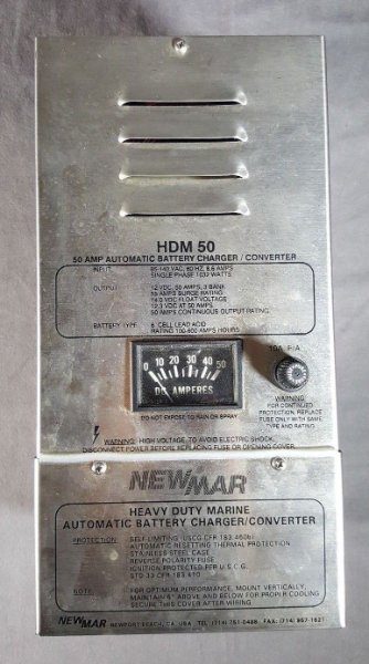

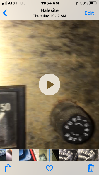

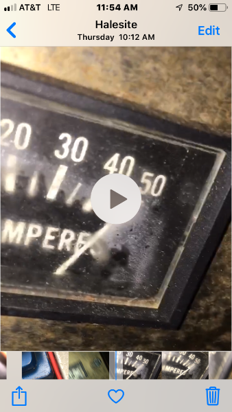

Anyone have a good charger recommendation. I want to save my recent investment and my back. Boat is plugged in at the marina and plugged into the house during the winter. I don't think what I have is a smart charger. Here are two really bad pictures of it. I can't find any identification on it to see what it is. It just has a gauge on the face with a fuse holder next to it.

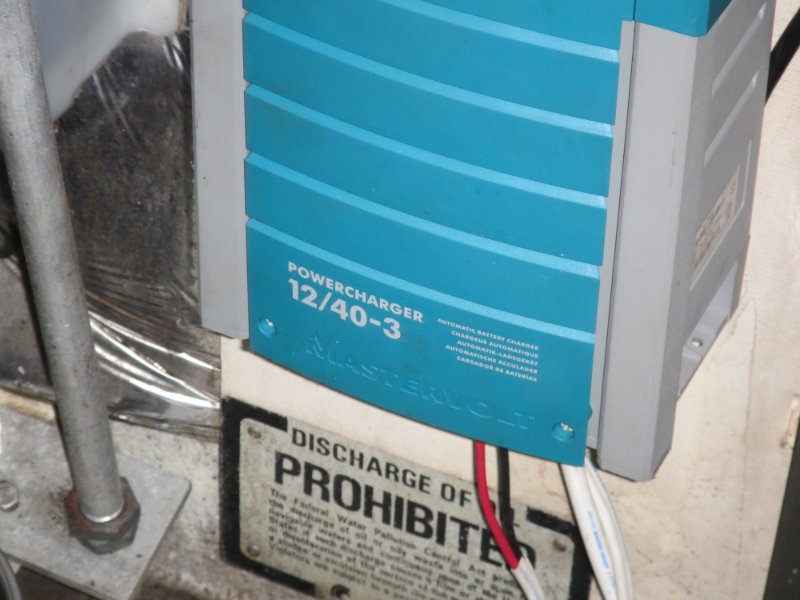

We really like our Mastervolt 12/40-3
We also added the remote monitoring for it.

I tracked down what was in there. Made by Newmar HDM-50.
