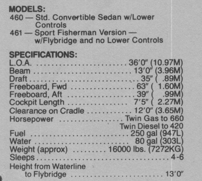

Re: f36 flybridge removal
I am in the same situation
Need to move an F-36 about 700 miles and per the hauler, the bridge and props need to come off
for the trip.
Anyone have blueprints or know the vertical distance from bottom of keel to the deck of the flybridge?
Thanks
for the trip.
Thanks
- Beacon Bob
- Posts: 276
- Location: Easton, PA
The F-36 Model 460 and 461 you will need to remove the flybridge and place it on the bow of the boat.
We should have the instructions that were given to install the Flybridge after it was transported from the factory. It could be used in reverse to remove.
You will also need the electrical drawings. Which should be in your Owners Manual. If you do not have the Owners Manual we can make one for you from your Hull number.
Give us a call and we can help you get started with the right documents.
Note ( Cradle Measurments) The cradle was about 6” to 8” off the ground and was always with the Flybridge removed.
Bob Cushman
609 713 4692
Bob Cushman
609 713 4692
- CF73AD7C-E657-41F6-A29D-6453D2D4349B.jpeg (136.91 KiB) Viewed 7186 times
